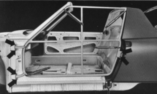

I already built door jigs.

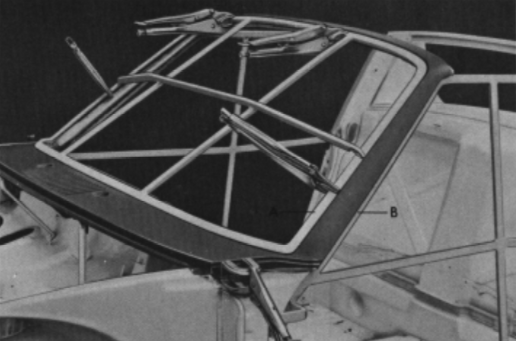

And I'll need to build a windshield jig.
Between the Celette, those jigs, and the factory chassis measurements I'll be able to confidently evaluate the TRUE condition of any and all 914 bodies.
