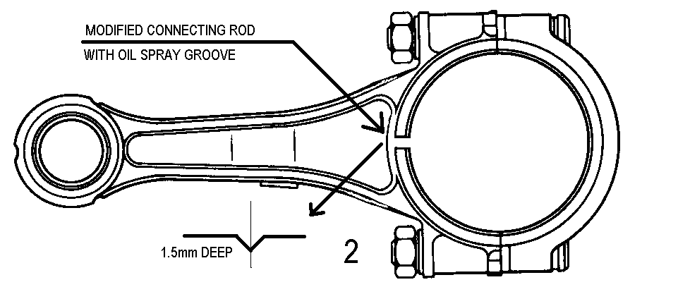

QUOTE(914Sixer @ Aug 9 2018, 04:43 AM) *
Aftermarket rods do not have an oil slinger slot that the factory 2.0L ones do.
(IMG:style_emoticons/default/confused24.gif) What oil slinger slot?
here is a doc that details how to cut/file one into the factory rods?

914Sixer   Are you using steel backed bearings? Aftermarket ...   Aug 9 2018, 05:43 AM

914werke   Aftermarket rods do not have an oil slinger slot ...   Aug 13 2018, 10:05 PM
