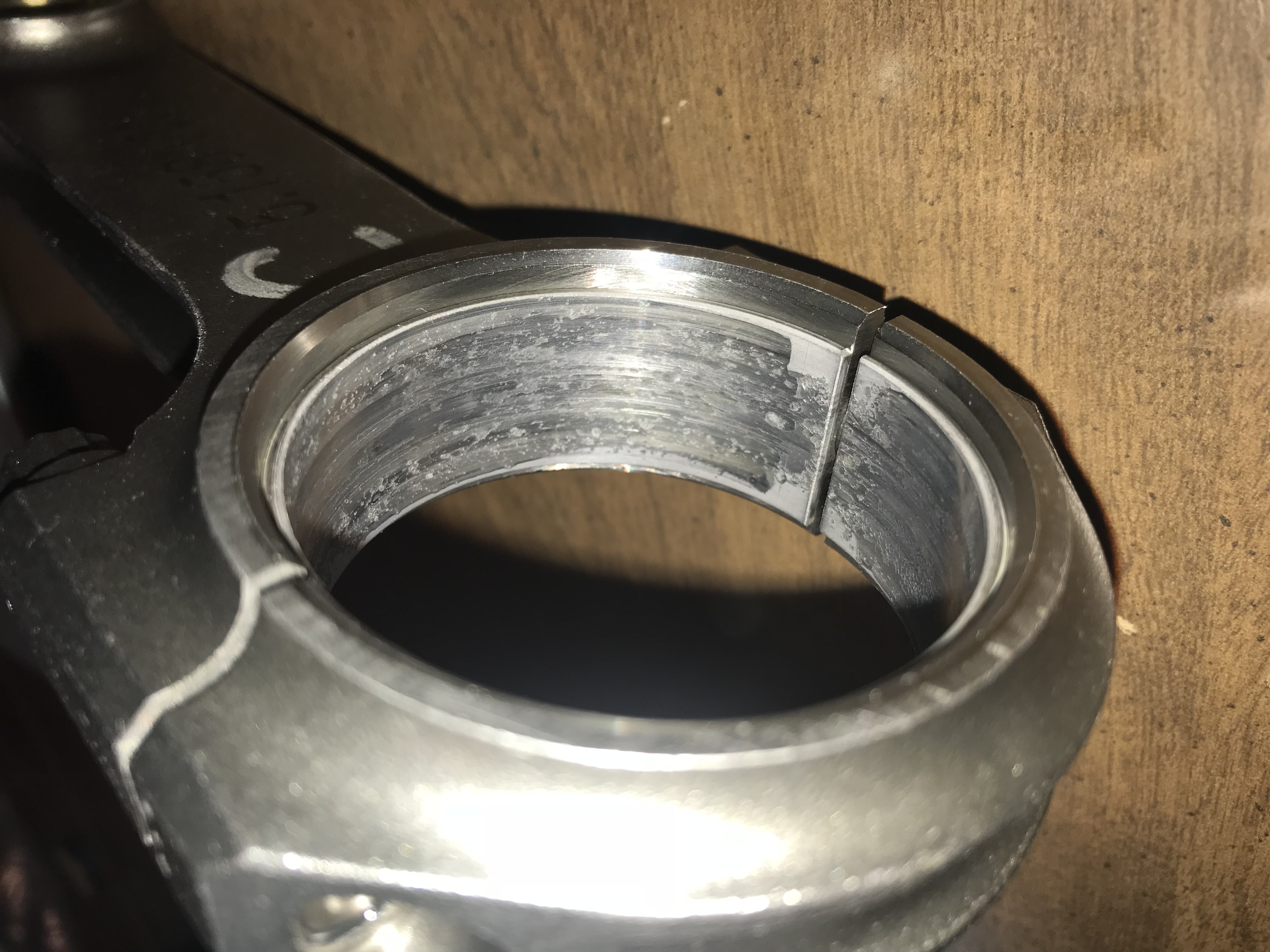

Driver174
Aug 8 2018, 11:50 PM
Rod bearings 1,2 & 4 look good, but #3 not so good. This engine has approximately ten race weekends sense it was rebuilt. Has anyone seen this issue?

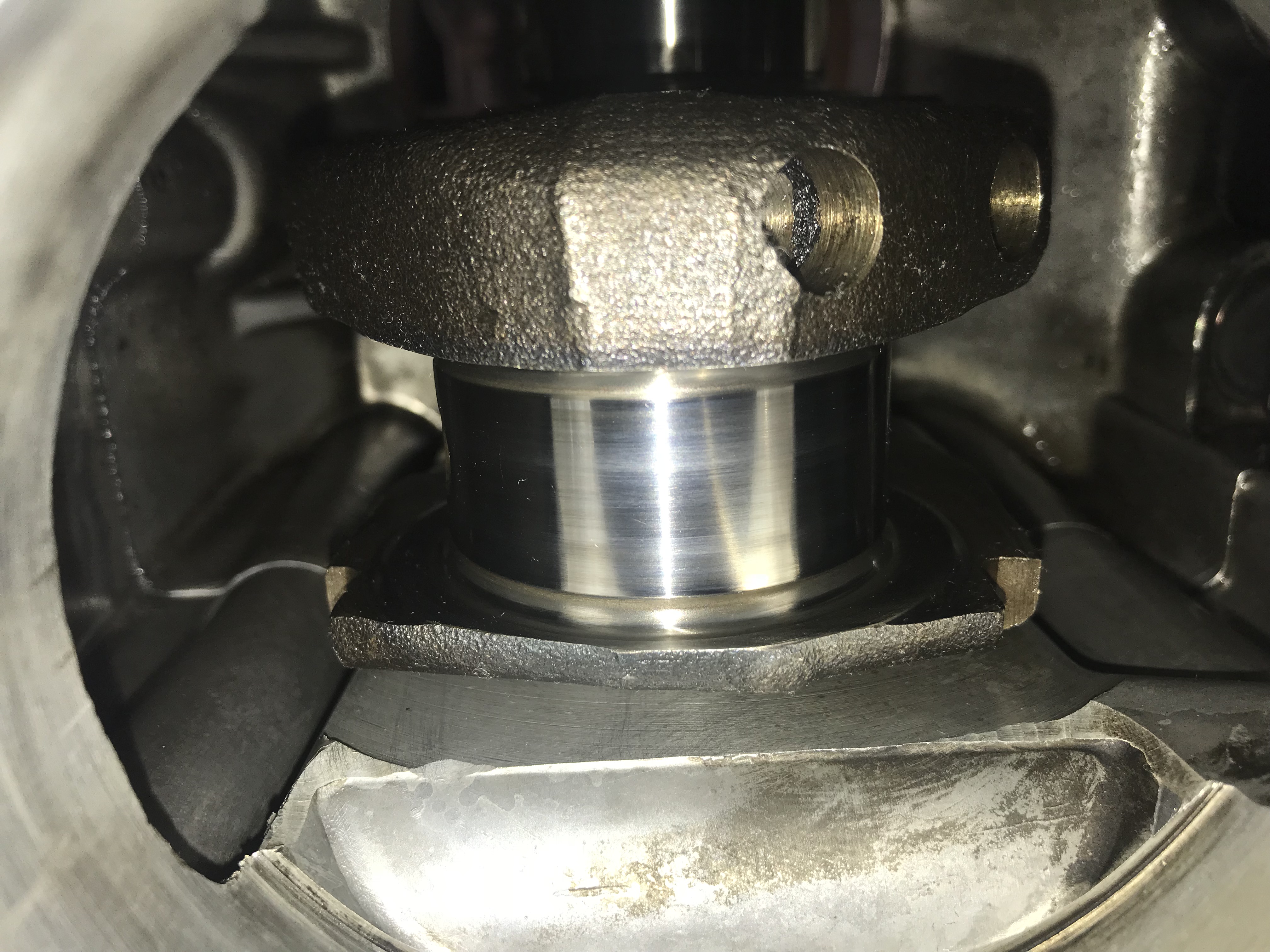

Driver174
Aug 8 2018, 11:55 PM
Pic of crank journal that doesn't look or feel much different from the other journals except for the marks left from the bearing material.
Krieger
I have not taken apart a motor with that little time on it. What does the crank look like?
flyer86d
Aug 9 2018, 04:52 AM
We had the same issue with our modified 1.7. With Sue and I driving it, I would have to rebuild the bottom end mid season running ten to twelve weekend per year. I had two shortblocks. The situation improved when I installed an external oil cooler.

Are you using steel backed bearings? Aftermarket rods do not have an oil slinger slot that the factory 2.0L ones do.

I have seen it in a street engine. That is the rod bearing that is farthest from the oil feed to the crank. So it is the first to suffer with oil starvation. It could be anything from an incorrectly installed main bearing restricting the oil flow to the crank, or some debris in the oil feed passage.
Hard to tell what caused it, but I would replace the crank and rods as a precaution.

Looks like an aftermarket rod in the pic at top? What rods are you using? Bearings? Any special prep on crank? Any details you can share on usage may help too - hp, RPM, any other significant details. Lots of variables for a race motor that can impact longevity, like oil temp, anything to help with oil starvation in corners (especially of you are running sticky tires).
ChrisFoley
Aug 9 2018, 07:03 AM
Do you have any deep sump or tuna can? Do you maintain the oil level 1/2qt above the full line?
You were lucky. If the bearing material started sticking to the crank it would have seized quickly.

looks like an oil control/starvation issue.
Why I like a pro light or some sort of bright idiot light.

I'm late to the party, but I agree with Mark and Chris. Even if your light didn't come on, it looks like starvation to me. You at least need a 'tuna can' sump. If you're serious about racing though, the AccuSump is a great investment specifically avoid situations like this -- and has the added benefit of letting you open the AccuSump reserve tank before cranking the motor and ensure there's a good coating of oil on all the bearings before turning the motor over.

In such a situation, what happens to the main bearings at that end? For the bearings to be so galled it almost has to be poor oiling doesn’t it?

The mains can actually take a bit more abuse than a rod bearing considering the multiple supports to the crank, and excess oil from the mains is what feeds the rod bearings.

Was there a rod knock? What made you look into this? The only (water cooled) engines I've torn down with a knocking noise were in much worse shape.

Driver174
Aug 14 2018, 09:57 PM
QUOTE(Tbrown4x4 @ Aug 13 2018, 08:57 PM)
Lots more surface area on the mains too.
No rod knock; was simply pulling rods to do the oil slinger modification while I had the top end apart to increase compression ratio.
