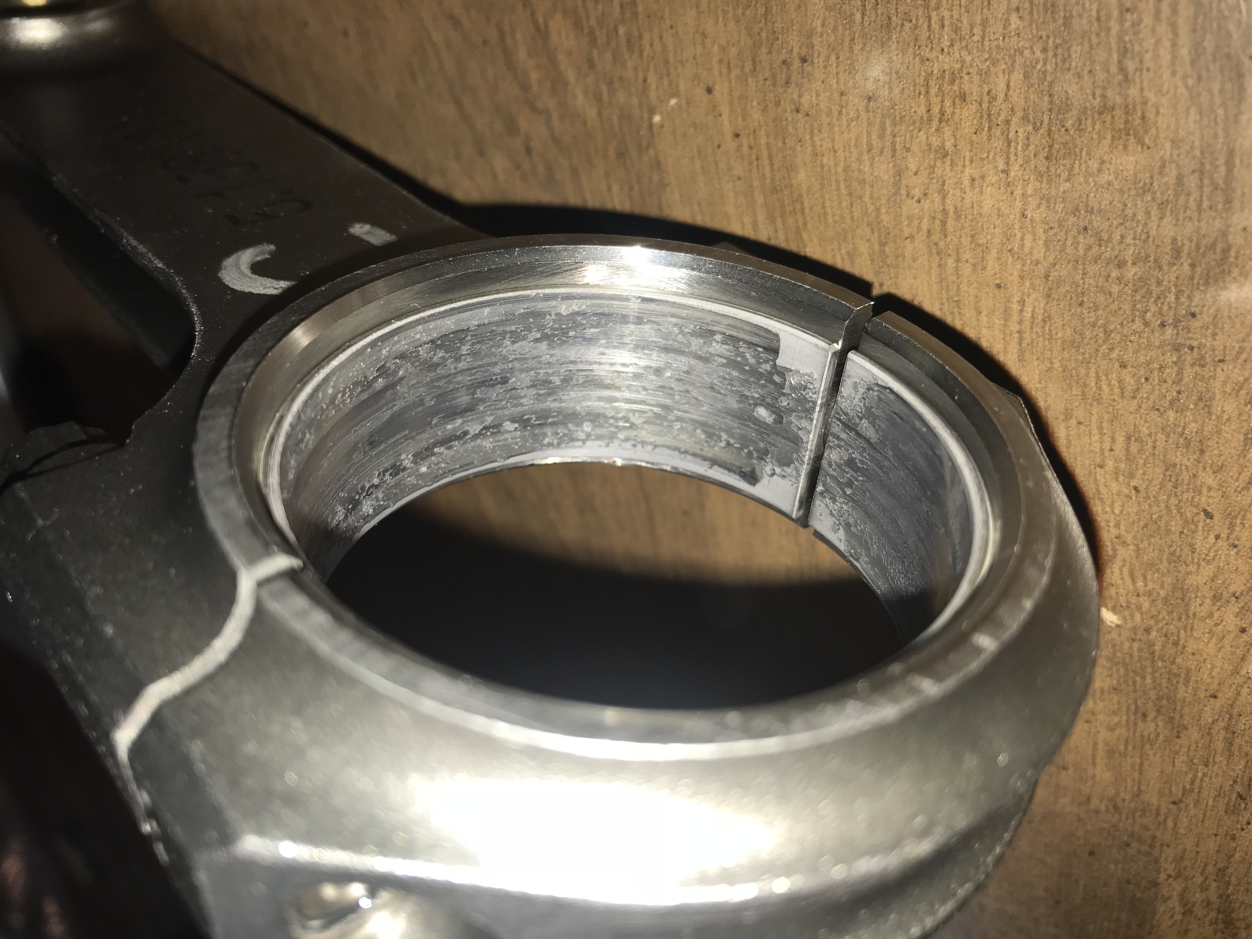

Rod bearings 1,2 & 4 look good, but #3 not so good. This engine has approximately ten race weekends sense it was rebuilt. Has anyone seen this issue?

Pic of crank journal that doesn't look or feel much different from the other journals except for the marks left from the bearing material.Attached Image

I have not taken apart a motor with that little time on it. What does the crank look like?

Are you using steel backed bearings? Aftermarket rods do not have an oil slinger slot that the factory 2.0L ones do.

I have seen it in a street engine. That is the rod bearing that is farthest from the oil feed to the crank. So it is the first to suffer with oil starvation. It could be anything from an incorrectly installed main bearing restricting the oil flow to the crank, or some debris in the oil feed passage.
Hard to tell what caused it, but I would replace the crank and rods as a precaution.

Looks like an aftermarket rod in the pic at top? What rods are you using? Bearings? Any special prep on crank? Any details you can share on usage may help too - hp, RPM, any other significant details. Lots of variables for a race motor that can impact longevity, like oil temp, anything to help with oil starvation in corners (especially of you are running sticky tires).

Do you have any deep sump or tuna can? Do you maintain the oil level 1/2qt above the full line?
You were lucky. If the bearing material started sticking to the crank it would have seized quickly.

(IMG:style_emoticons/default/agree.gif) looks like an oil control/starvation issue.
Why I like a pro light or some sort of bright idiot light.

I'm late to the party, but I agree with Mark and Chris. Even if your light didn't come on, it looks like starvation to me. You at least need a 'tuna can' sump. If you're serious about racing though, the AccuSump is a great investment specifically avoid situations like this -- and has the added benefit of letting you open the AccuSump reserve tank before cranking the motor and ensure there's a good coating of oil on all the bearings before turning the motor over.

It has the "tuna can" oil sump and an oil cooler mounted in front trunk. The oil gets quite hot; I think I've seen 240-250 degrees on gage during races.
I asked the original engine builder if I should install an AccuSump, but he claims that he has many of these racing with just tuna can, and never had oiling problems.

In such a situation, what happens to the main bearings at that end? For the bearings to be so galled it almost has to be poor oiling doesn’t it?
