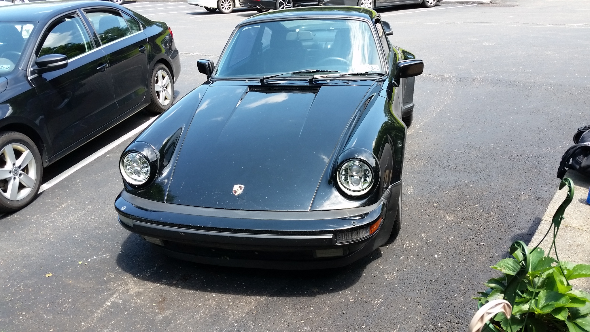

I went with Carmagic (Engelbert; rothaus on PelicanParts) LED headlight for my 930. Engelbert was very responsive to questions and everything fit nicely.
The headlight light pattern has that sharp cutoff at the top between light/no light as many vehicles have today.
The headlights also has an extra wire that can be connected to the running lights for DRL. On the 911 this is very convenient as the running light wires run through the headlight bucket and were a breeze to connect.
The high beams are primarily 4 high powered LEDs on each lamp which lights up everything in sight. The primary LEDs do not dim or turn off when the high beams turn on.
