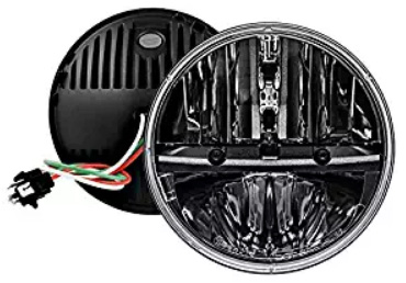

truck lite led for jeep wrangler. I've purchased for as low as $100/each on amazon. but usually list for $150. They are the best. Look a little odd but lights are usually down unless you are using them. They run cool and don't dim on idle even with my old 1,7.
Lot's of light on low, even to the side. Great cut off. High beams are insane.
https://www.amazon.com/Truck-Lite-27270C-LE...dlamp&psc=1

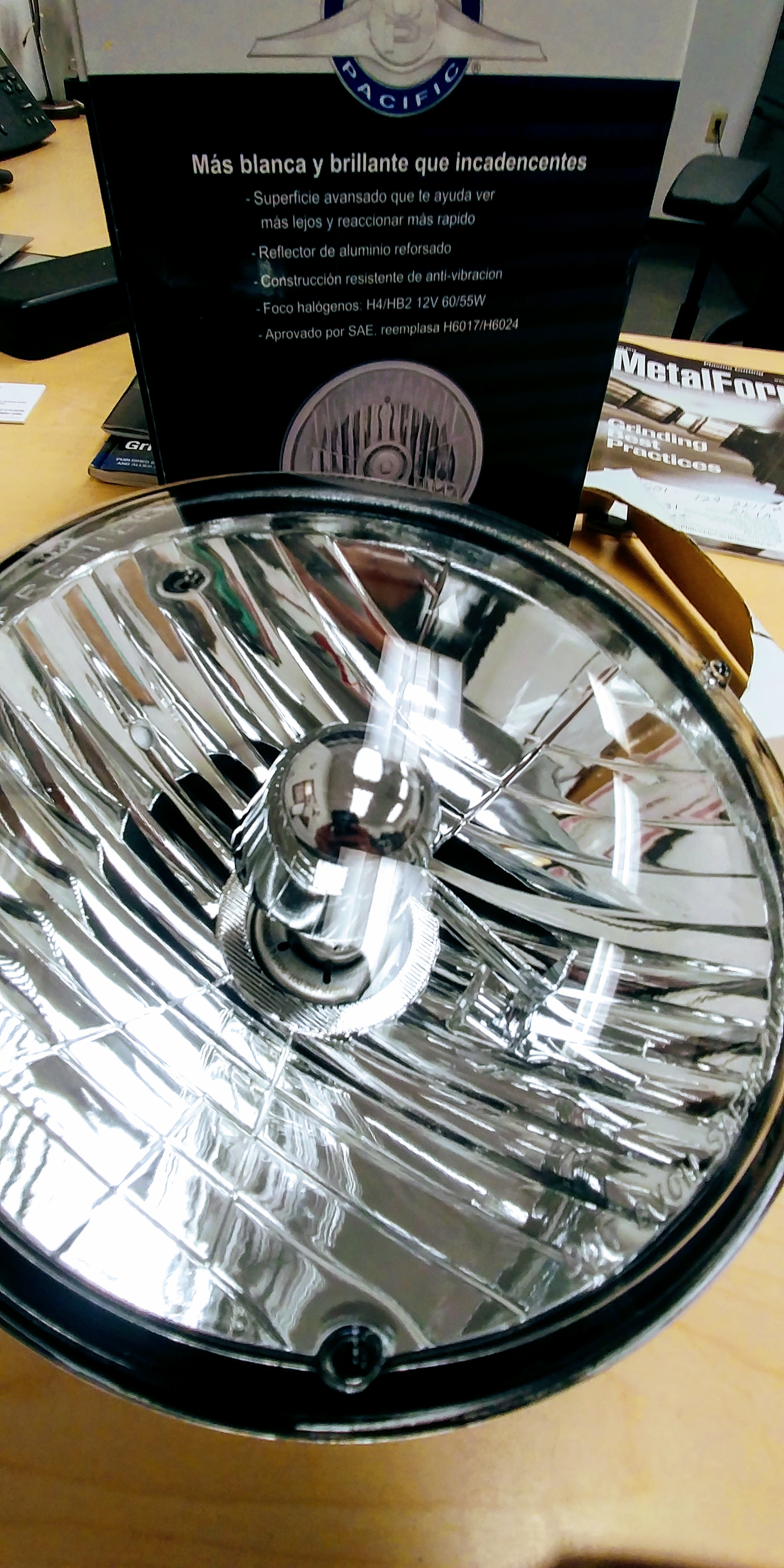

This is what I chose.. From a kenworth dealer these are just h4. And I will use the 914 rubber LED bulbsClick to view attachment

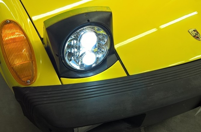

This is the 914Rubber kit. It’s important to me that the car not look “out of place” ie: people don’t point and say ‘hey! That’s not stock.’
As you can see in the side by side, the LED light blows away the H4. Imagine if I was to compare to a regular sealed beam!

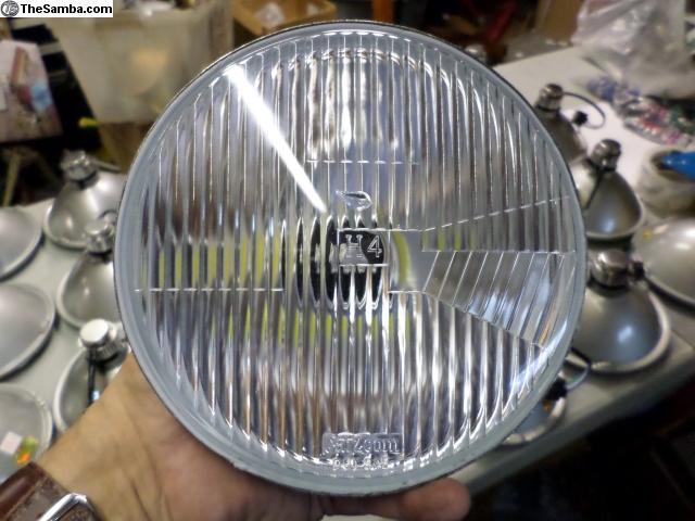

On a somewhat recent thread on the subject, someone recommended these from TheSamba. I don't have any experience but thought they looked interesting enough to save the link.
IPB Image
https://www.thesamba.com/vw/classifieds/det....php?id=2174710

Here’s my comparison.in the garage. Pattern looks identical at this distance.
