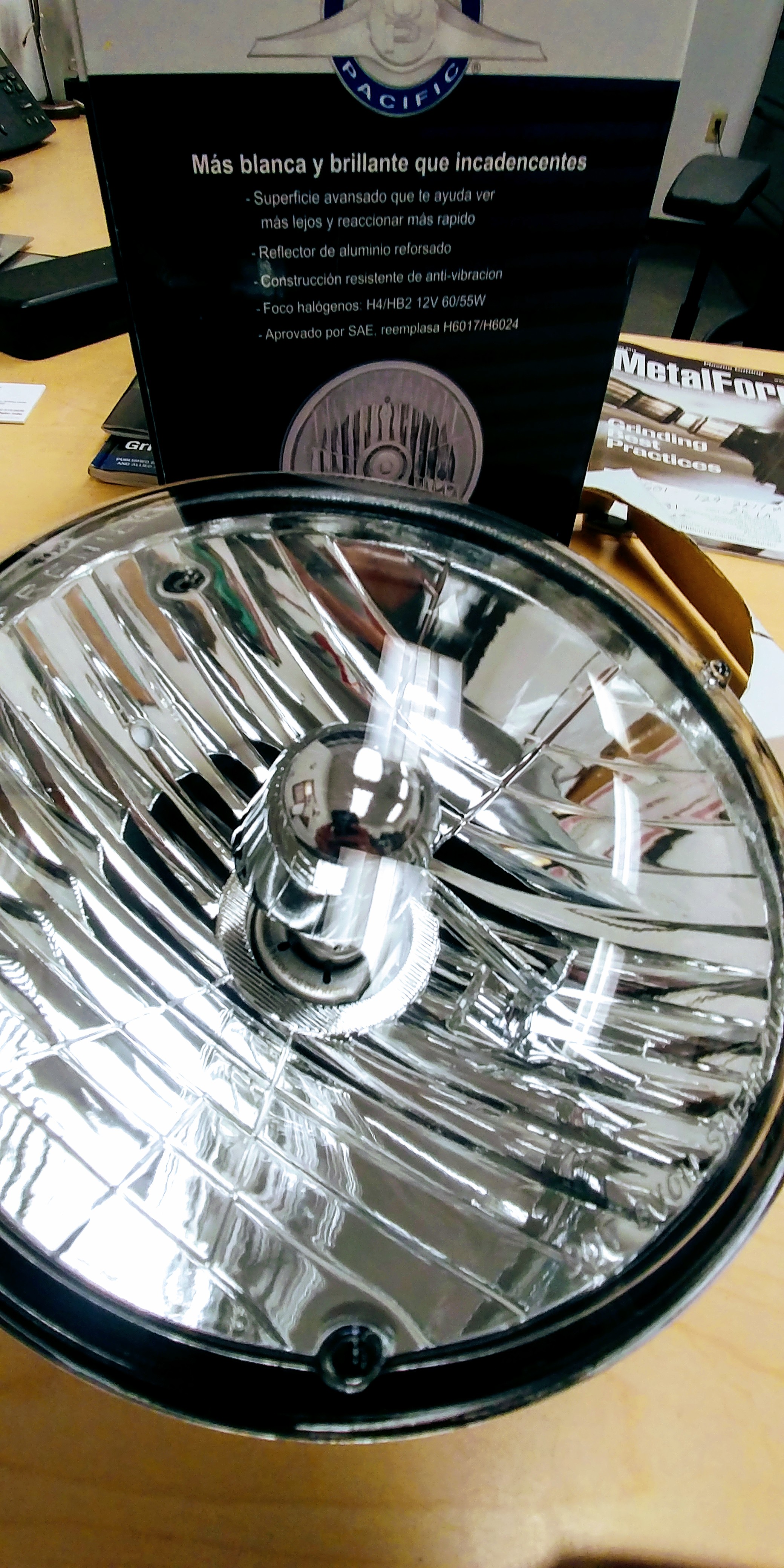

One issue with putting LEDs in standard H4 enclosures is that the reflectors don't always work well with the LED beam pattern. Usually it is a must to change the standard H4 reflectors when going to the LEDs for the best results but some do work.
Also Check out Vintage LED as they have 4000 and 5500 L versions along with quality Hella H4 reflectors.

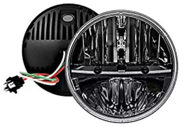

This is what I chose.. From a kenworth dealer these are just h4. And I will use the 914 rubber LED bulbsAttached Image

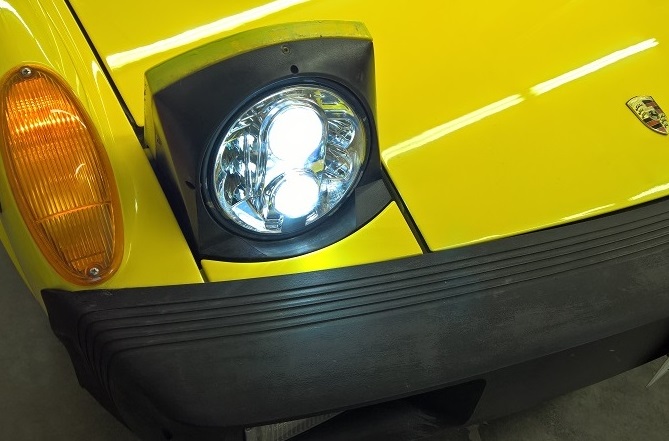

This is the 914Rubber kit. It’s important to me that the car not look “out of place” ie: people don’t point and say ‘hey! That’s not stock.’
As you can see in the side by side, the LED light blows away the H4. Imagine if I was to compare to a regular sealed beam!
