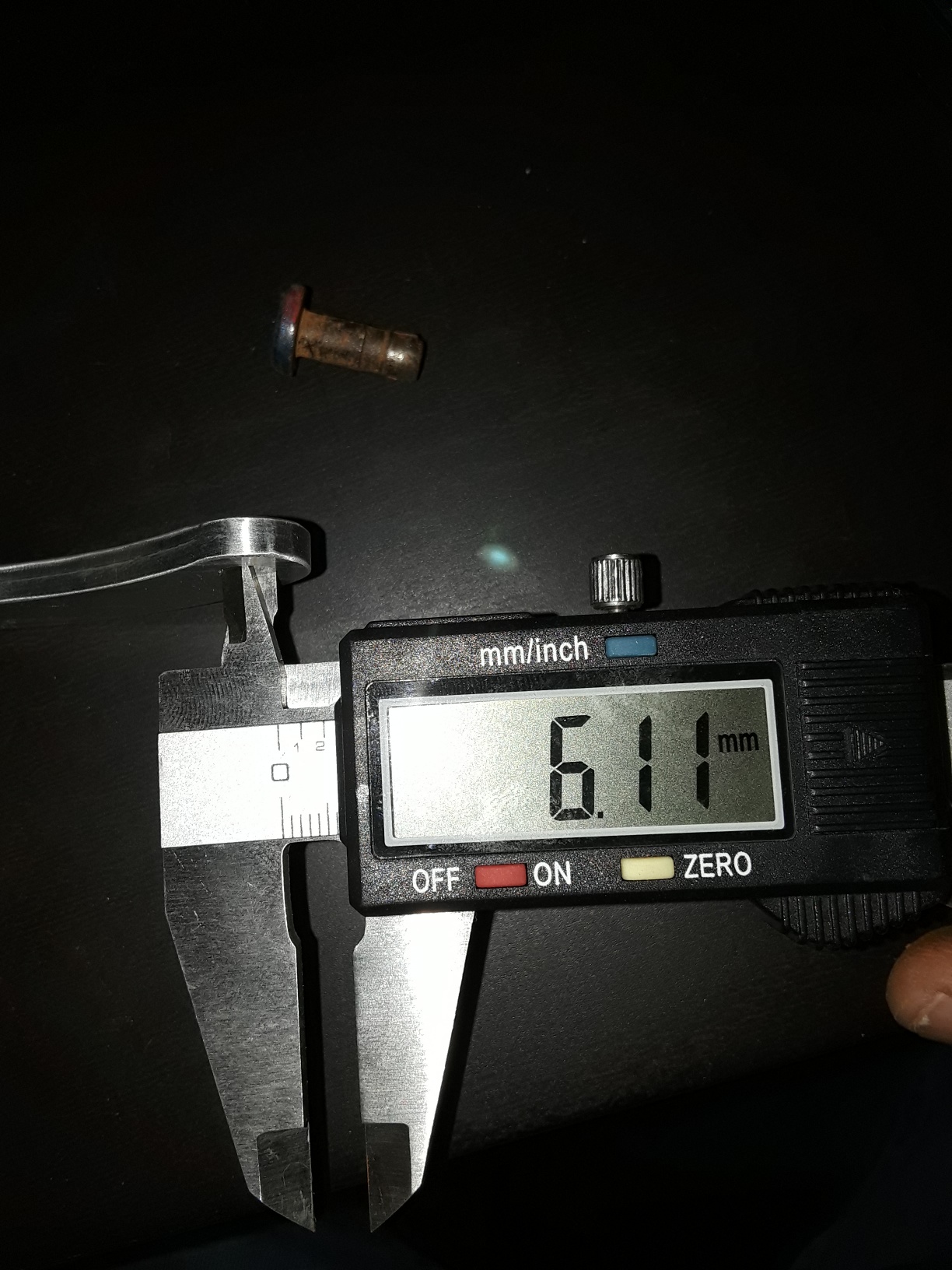

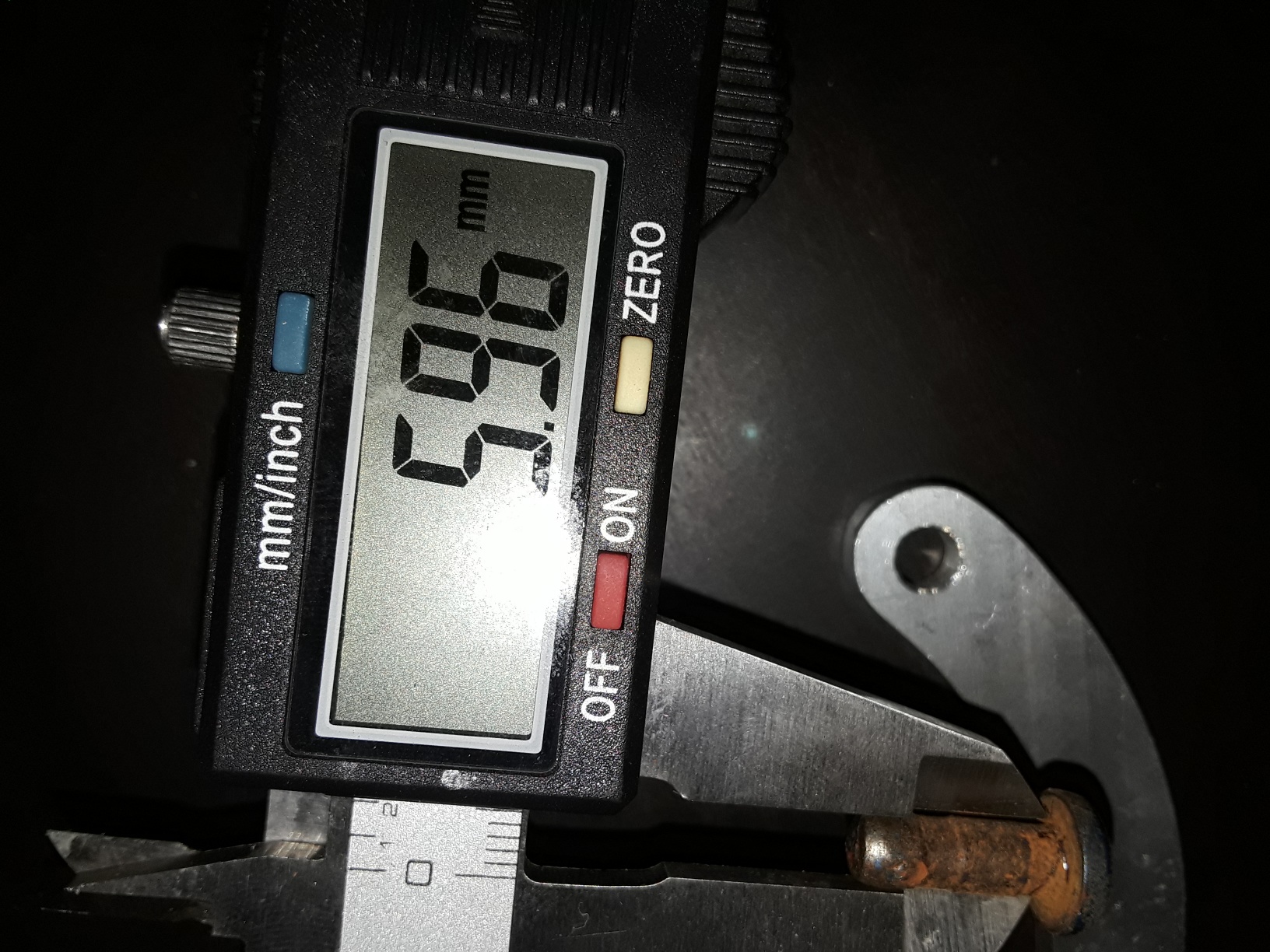

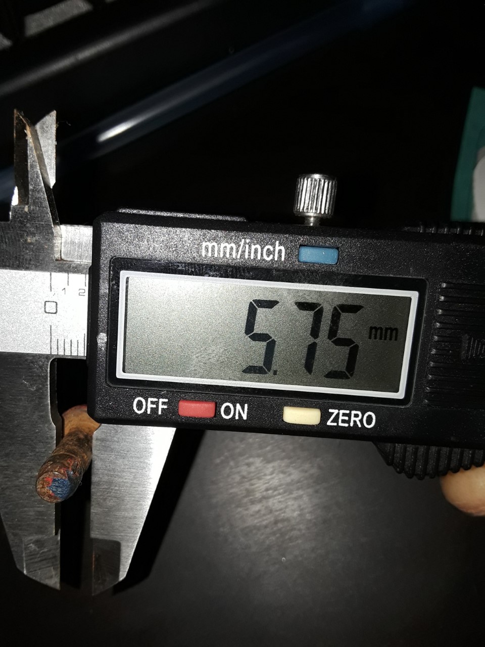

Guys I've checked the tolerance on the parts our holes are .01mm oversize but well within tolerance.
The problem I believe is the pin It's a 6mm pin. It appears to have worn down from its 6mm shaft size to 5.75 on my car, and it wasn't popping.
As you can see the nominal is 5.95 for the shaft, however the area that interacts with the pin is 5.75.
We did make our stays for the pins when new, so I think this may be where the popping is coming from.
