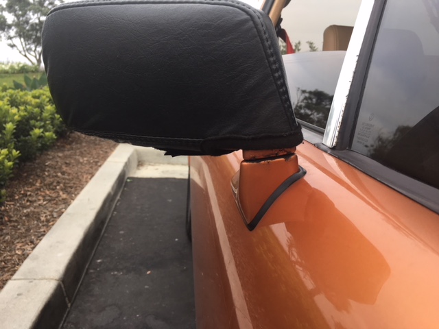

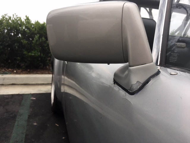

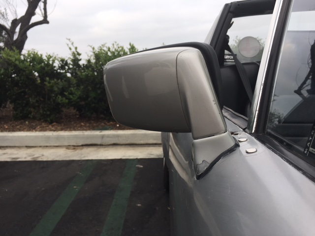

Steve and I compared pass side mirror bases this am. It turned out my pass side base is a Right-hand drive spec the angle is a little off, but i’ve Been able to see ok; the glass is maxed inward though. I rely more on a wink mirror for traffic in the right-rear
The copper motor is mine, silver ( correct base ) is Steves
