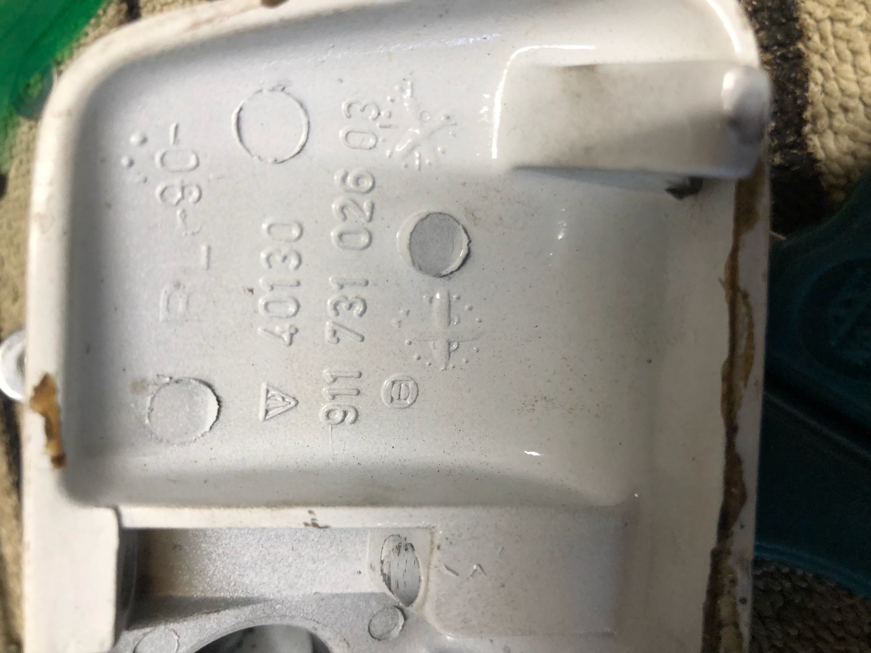

jim_hoyland
post Aug 25 2018, 04:43 PM
Get that VIN ?
Posts: 10,080
Joined: 1-May 03
From: Sunset Beach, CA
Member No.: 643
BTW: I need a pass side base !
PN# 911.731.026.03
The number is stamped on the base. If you want to sell, PM me
