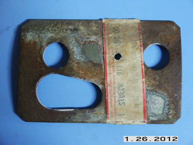

Well, I finally got around to taking some measurements. I did not take the mirrors off, but rather took measurements from 3 points on each door to the base of the rubber gasket. On this first picture...the key to the alignment is the yellow line...that line when looking at the car from the front should be vertical on both sides!
Also, for strength, you must use the 911 backing plate. I riveted mine on after having the holes cut in.

Harpo   I have my mirrors, gaskets and reinforcement piece...   Sep 30 2011, 07:28 PM
