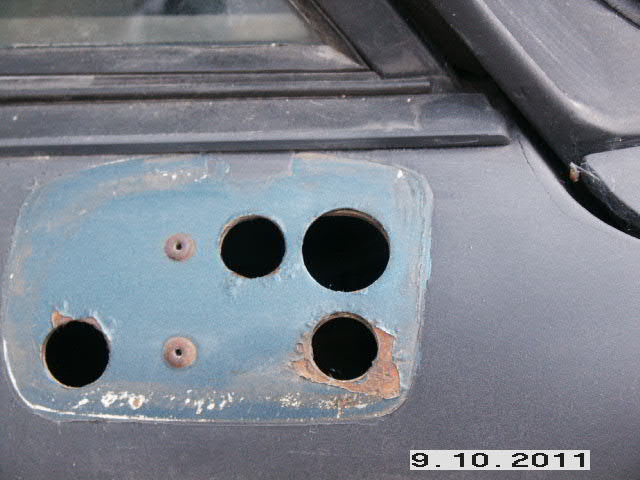

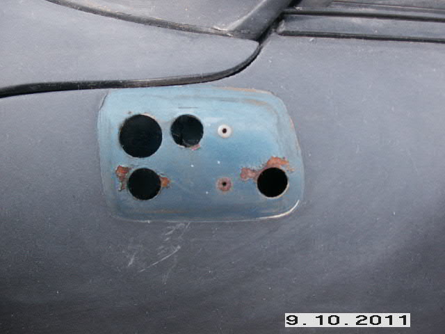

jim_hoyland   I found a 911 that had the mirrors removed and cop...   Sep 30 2011, 08:40 PM
jim_hoyland   Here's the pics; My pass mirror is more forwar...   Sep 30 2011, 09:04 PM
