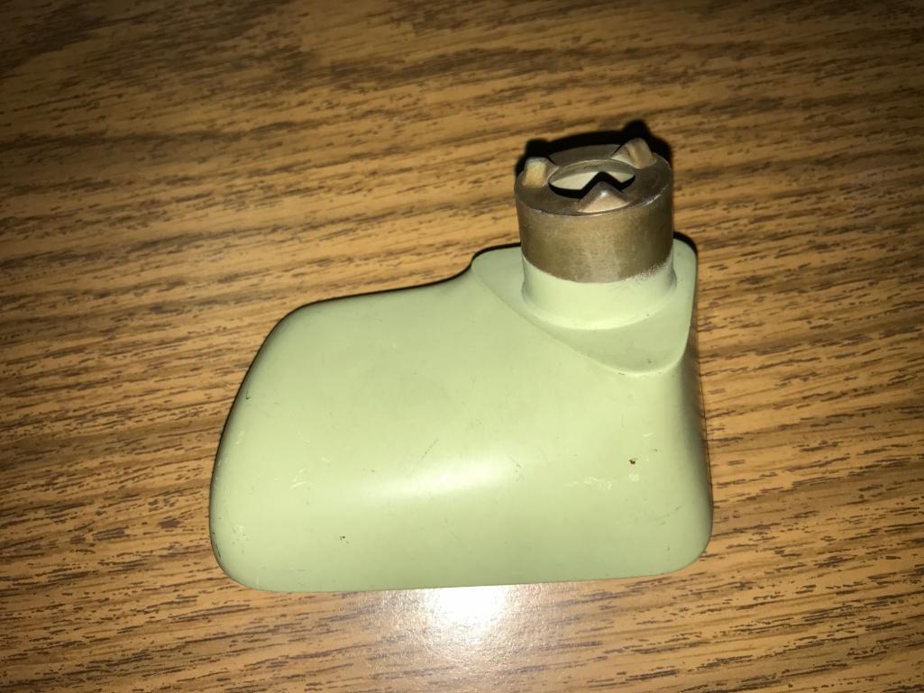

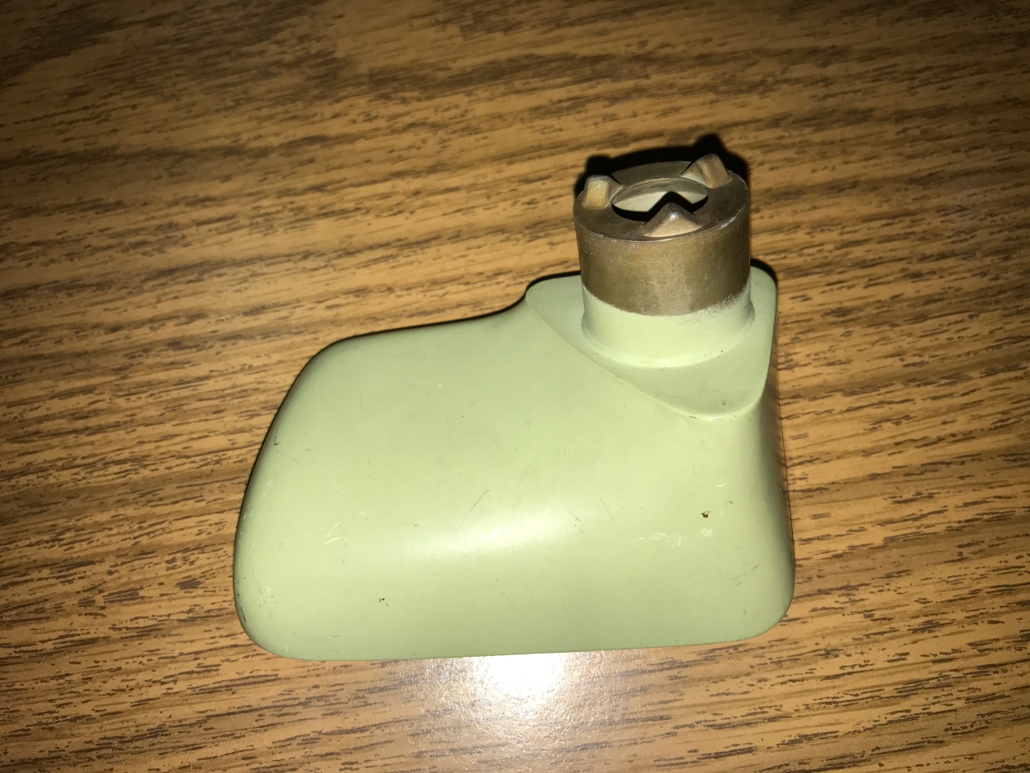

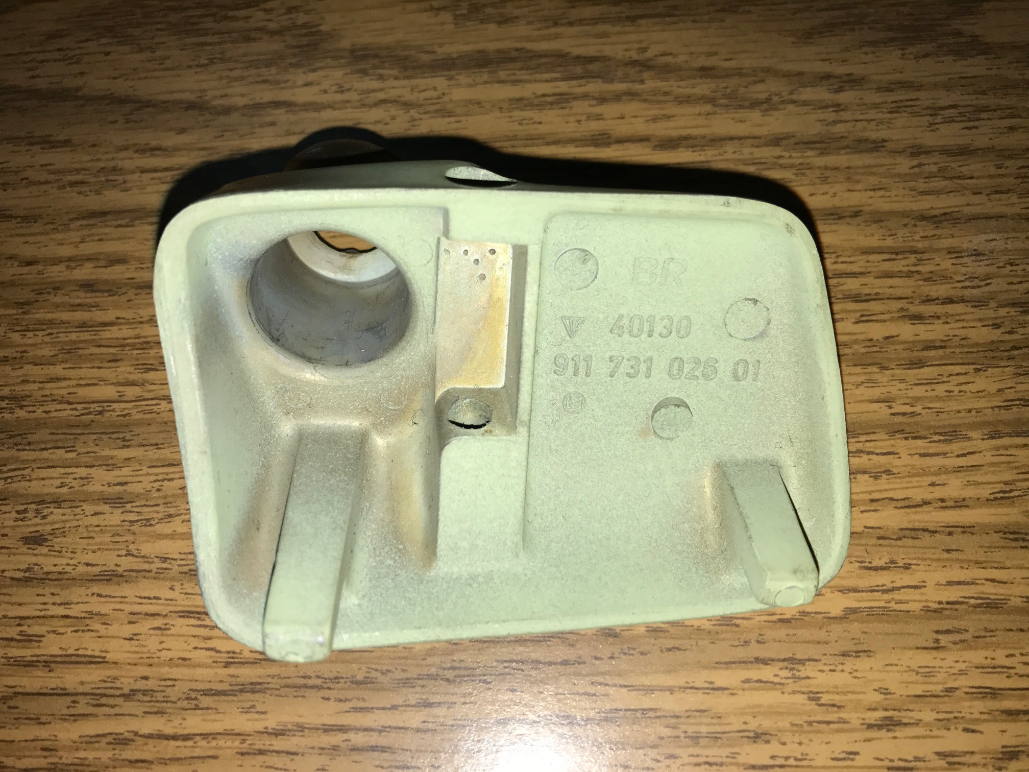

In searching for an exact replacement for the passenger side door, I got this pic and explanation. I'm not certain the angle is correct, but I'm going to wait for the original number shown above by Steve and I
Vendor: "this is an original one from back in the 80s before it was superseded to that part number you're asking about but this was used on 77 930 and 911 all the way up until the later 80s. For sure it's a right-hand US mirror base"
