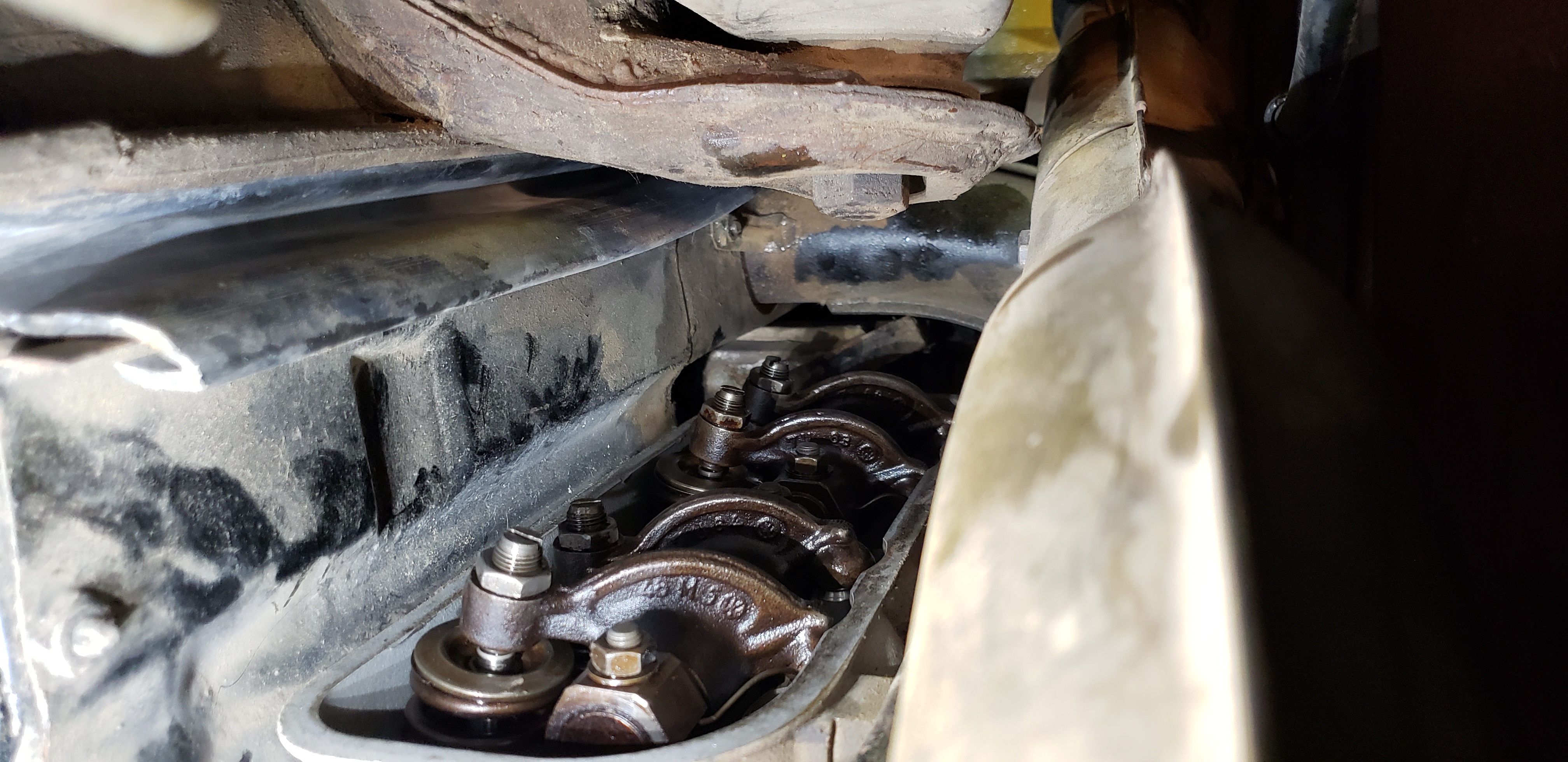

Finally got the stupid cover off.
My feeler gauges are somewhere safe, I will have to search around for them. They all feel secure, one of them does not feel any different than the others.
