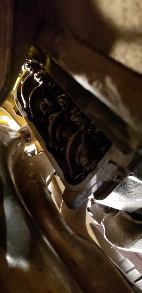

Drivers side.... I struggled for about 30 minutes to get the dang cover off but once I decided to remove the wheel it provided much more room and it came off pretty easily.
Definitely have an issue with the very first valve (towards the front of the car).
All the others are secure in their 'seat' (?) but the one in the front I can move back and forth (towards the front of the car and towards the back of the car). It's obviously on a spring or something because it puts itself back at the start.
Visually it also appears to sit slightly lower then the rest of the valves (picture attached).

TheCabinetmaker   Not a valve adjustment problem. Dropped valve seat...   Sep 4 2018, 09:55 AM

HerdofCrickets   Finally got the stupid cover off. My feeler gauge...   Sep 4 2018, 08:09 PM
