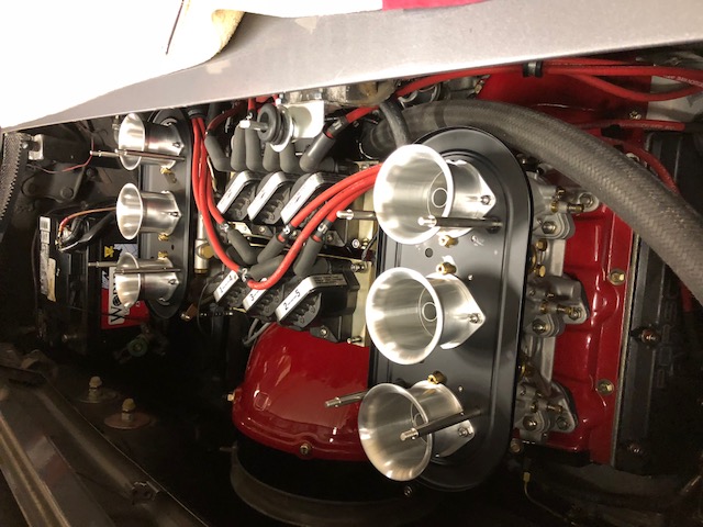

wrapping this up. I replaced Webers with PMO. l cannot extoll too much my satisfaction with PMO and Mr. PMO, Richard Parr. He called me a couple of times. He called my mechanic on a Sunday as he was concerned that we were having trouble getting the engine running right. Turns out we needed 50 idle jets, not the 55's originally included. Richard overnighted them and the car was perfect the next day. It screams and really pulls, especially in 3rd gear. It was a 9-month process but I am very happy. Now, I hope to get in some DE/track events before the bad weather arrives.
Installed. Porn. Hate covering them up with the air filters.
