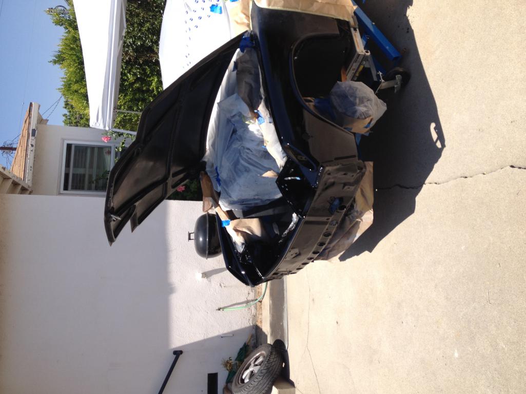

I used a 1.4 tip for the single stage black, used the 1.8 tip to shoot the epoxy, same gun.
