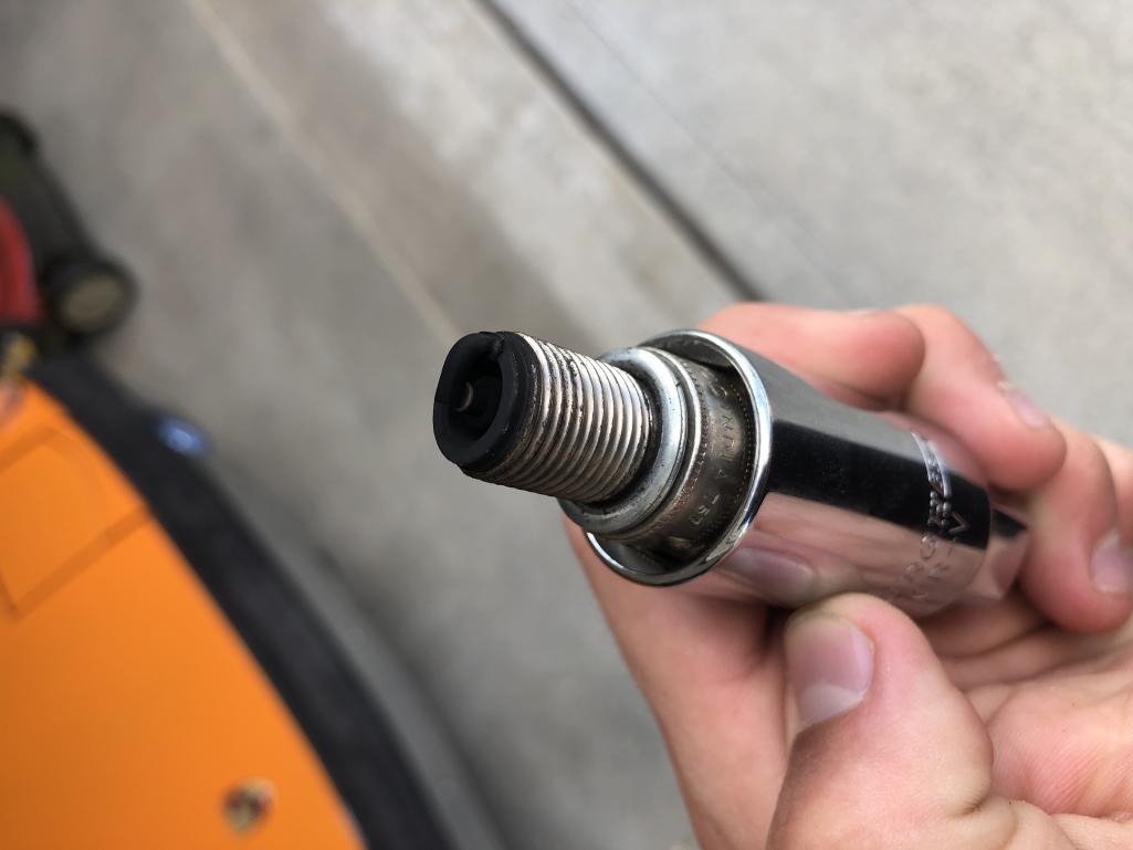

**BUMP** Update, car starts now. Will run and drive but not great. Pulled the a spark plug and they look like this. This is brand new. Lol. Ideas on what would cause it to run this rich? Attached Image

brianp626   **Update** sprayed some starter fluid in the intak...   Jul 31 2018, 05:58 PM
Spoke   If you haven't done a tune-up on your new car,...   Aug 1 2018, 05:21 PM
brianp626   Yea, I’m thinking about taking it to a local Vol...   Aug 1 2018, 05:33 PM
BeatNavy   Not sure what that is in the bottom picture, but t...   Aug 1 2018, 06:07 PM
brianp626   but the top picture is one of the lines that goes...   Aug 1 2018, 07:19 PM
76-914   Could these be the hoses from the charcoal filter ...   Aug 1 2018, 08:01 PM
brianp626   Could these be the hoses from the charcoal filter...   Aug 1 2018, 08:06 PM
Dave_Darling   One of those hoses goes from the fan shroud to the...   Aug 1 2018, 09:58 PM
brianp626   One of those hoses goes from the fan shroud to th...   Aug 3 2018, 11:13 AM
brianp626   I started the car when I got home from work yester...   Aug 3 2018, 11:17 AM
Dave_Darling   The other hose doesn't go to the throttle body...   Aug 3 2018, 01:02 PM
76-914   What is the ohm reading on the CHT sender when it ...   Aug 3 2018, 05:18 PM
brianp626   What is the ohm reading on the CHT sender when it...   Aug 6 2018, 08:48 PM
