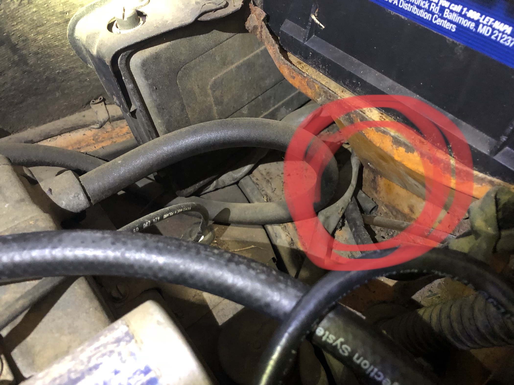

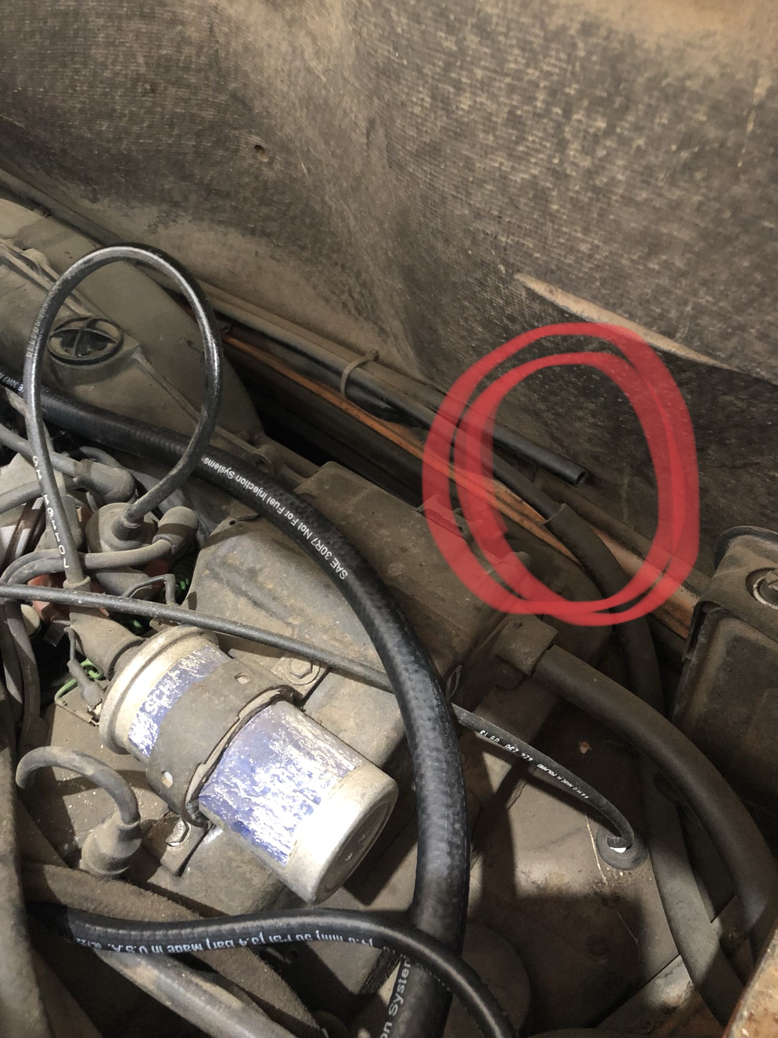

Any idea where these lines go? They appear to just be open.
Click to view attachment Click to view attachment

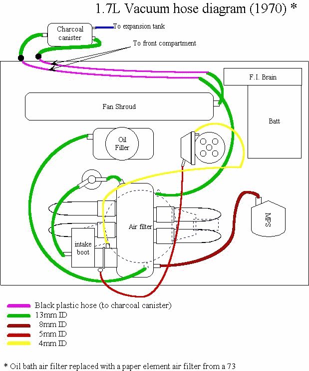

Not sure what that is in the bottom picture, but the top picture is one of the lines that goes to the fuel charcoal canister up front. The "fuchsia" (magenta?) lines in the picture below:

Does that one in particular just vent to atmosphere?

Could these be the hoses from the charcoal filter to the fan? Check your fuel line for good flow. Sounds like you have a fuel delivery problem. There are screens in the tank nipples that can become clogged. Your fuel pressure should be about 29psi.

One of those hoses goes from the fan shroud to the charcoal canister up front. The other one goes from the canister to the air filter. It basically dumps air with some fuel vapor into the intake upstream of the throttle body.
I don't remember which is which, but it's not a good idea to swap them...

Well there’s already one going to the fan shroud so I guess I just need to figure out which one goes to the TB. I have a capped port on the TB so I bet that’s where it goes. Not sure why it would be capped though. Thanks for the help.

The other hose doesn't go to the throttle body, it goes to the air cleaner.
