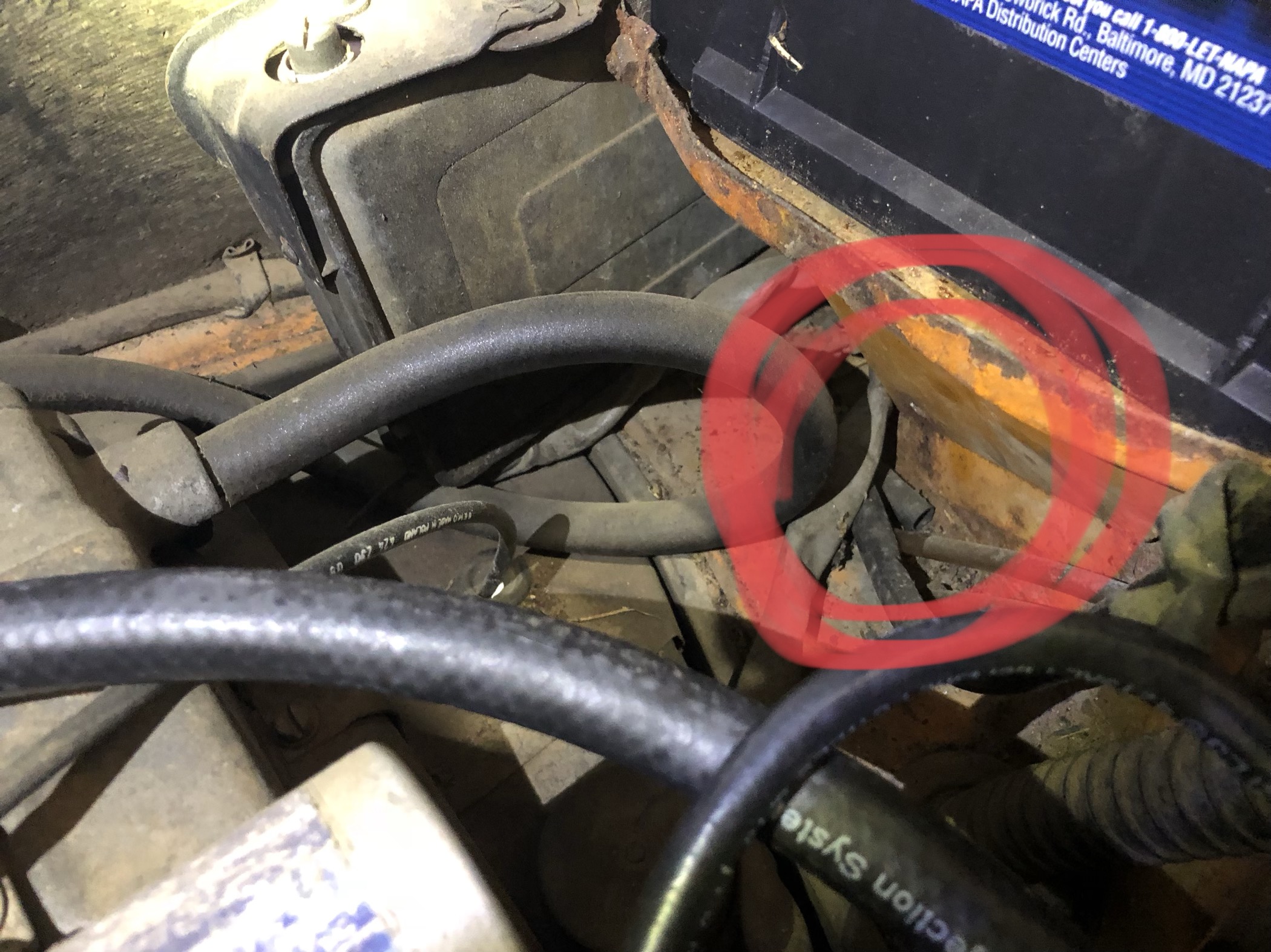

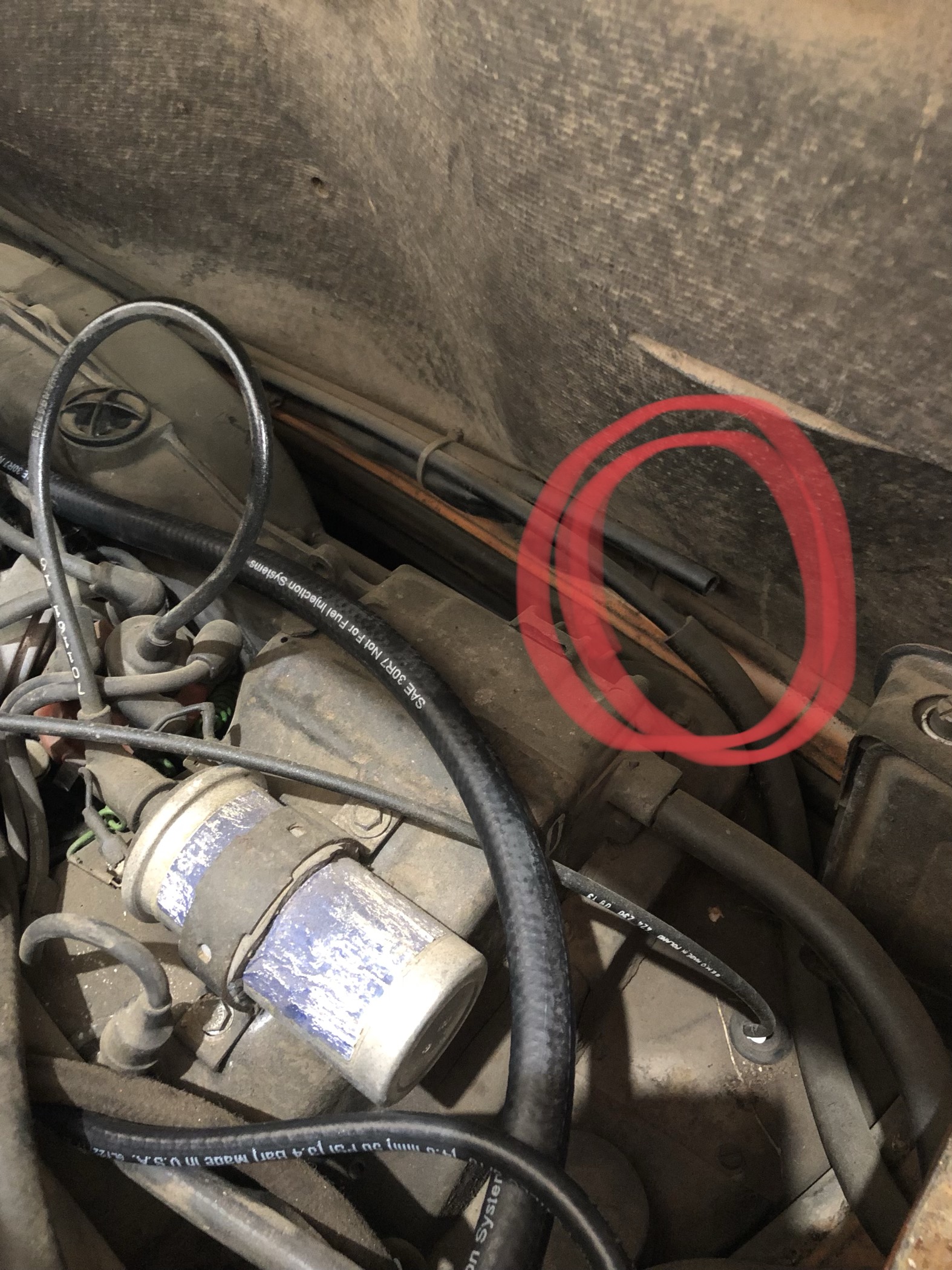

Any idea where these lines go? They appear to just be open.

Not sure what that is in the bottom picture, but the top picture is one of the lines that goes to the fuel charcoal canister up front. The "fuchsia" (magenta?) lines in the picture below:

QUOTE(BeatNavy @ Aug 1 2018, 08:07 PM) *
Does that one in particular just vent to atmosphere?

Could these be the hoses from the charcoal filter to the fan? Check your fuel line for good flow. Sounds like you have a fuel delivery problem. There are screens in the tank nipples that can become clogged. Your fuel pressure should be about 29psi. (IMG:style_emoticons/default/beerchug.gif)
