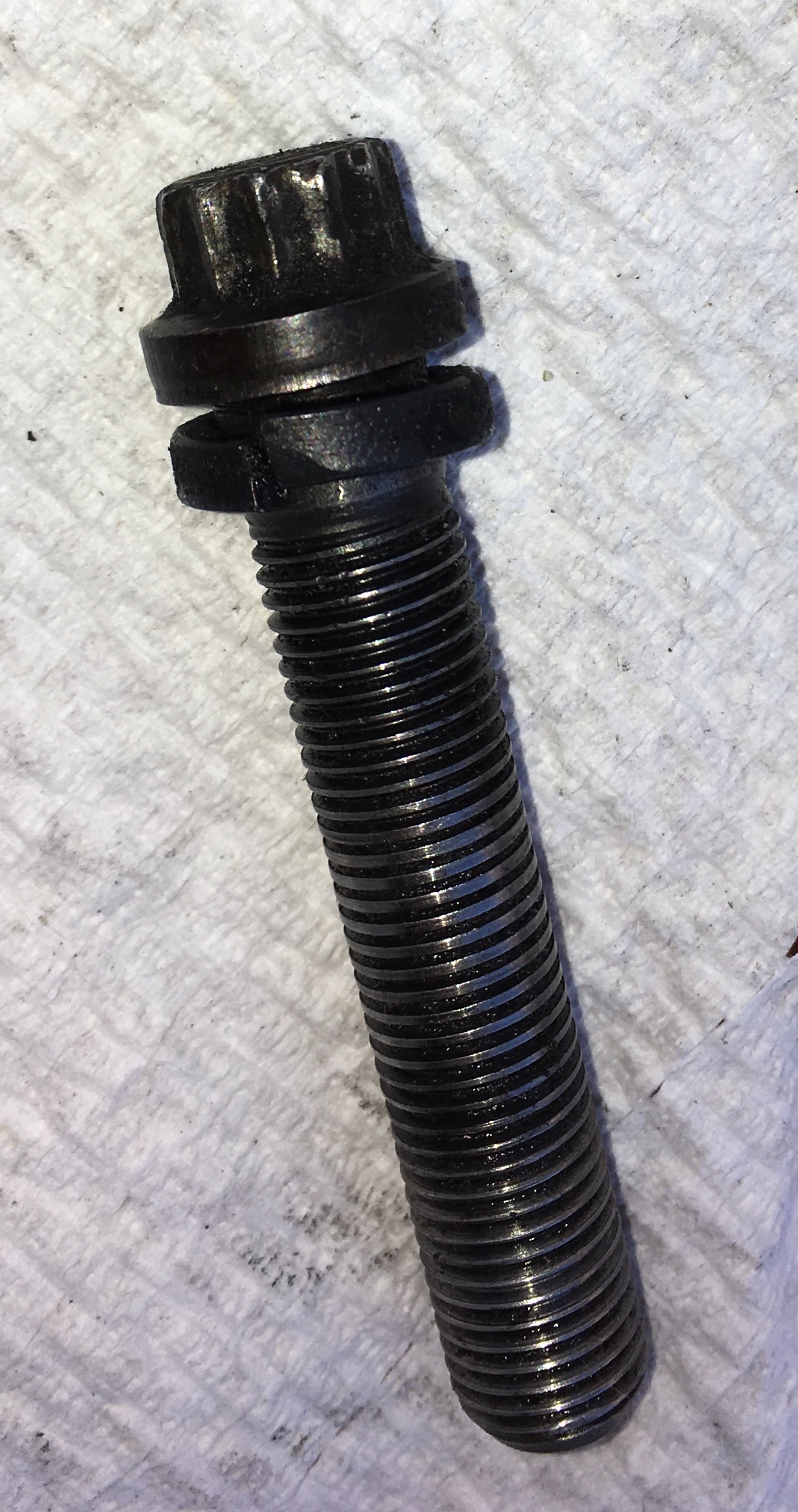

Pulled one to go make sure I get the right size washers. The split washers on here for apparently useless, and the threads were very greasyAttached Image

QUOTE(Tdskip @ Oct 15 2018, 06:49 PM) *
Those bolts are not the original type of bolt used for 914 CV joints.
I would be ordering some new bolts and probably get the "drilled for safety wire" bolts since I was getting new bolts.
You need to be sure the bolts are the correct strength.
Jim

914sgofast2   It’s the wrong bolt for the CV joints. They are ...   Oct 15 2018, 08:05 PM
Mark Henry   That's not a factory bolt or washer.   Oct 15 2018, 07:56 PM
SirAndy   That bolt doesn't look right, also, the center...   Oct 15 2018, 07:57 PM
Mark Henry   That bolt doesn't look right, also, the cente...   Oct 15 2018, 08:06 PM
