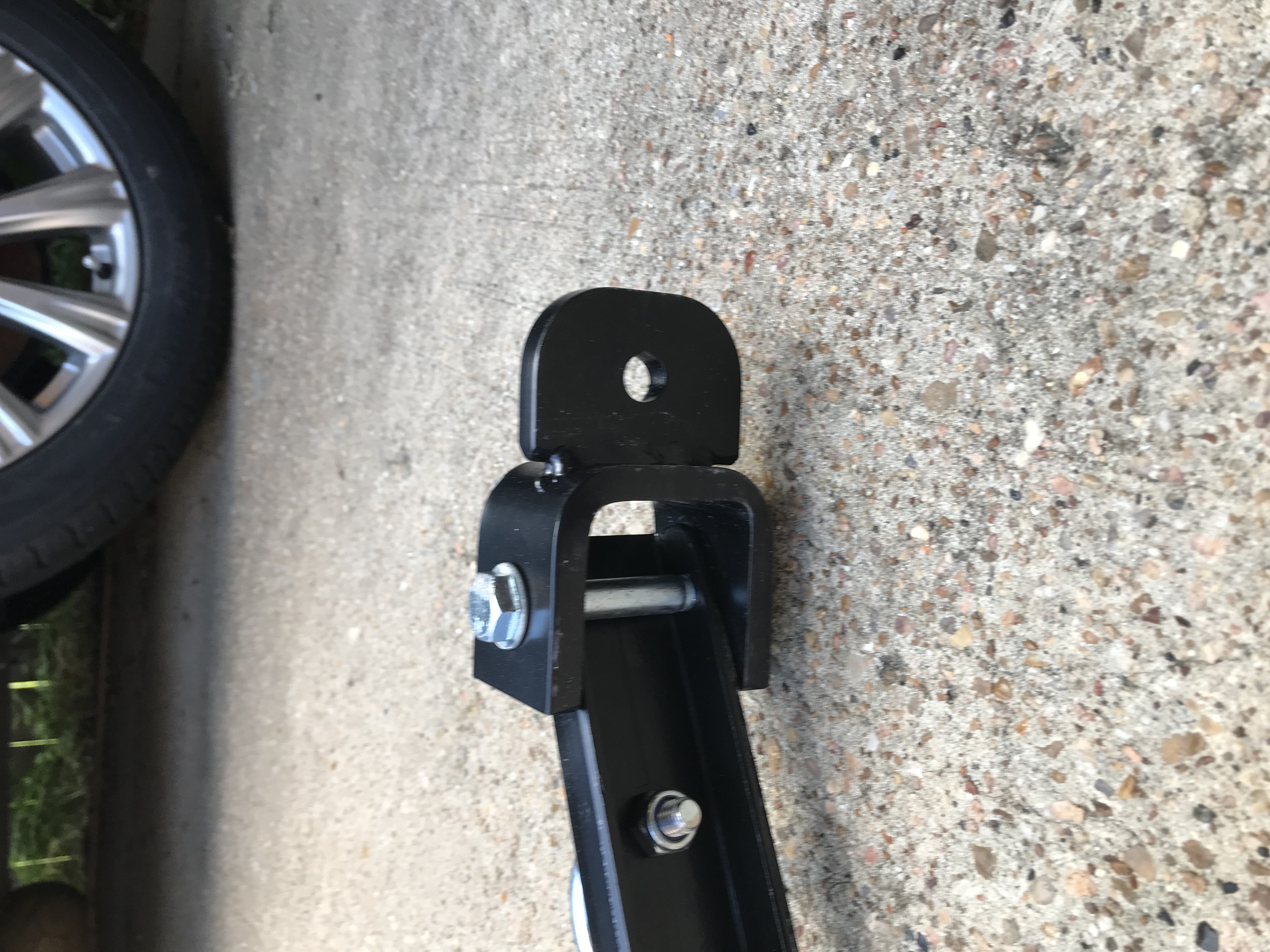

All the discussion about adapters and spacers has me confused.
I bought the flat tow bar kit. I bought the harbor freight towbar. Both just came in. Do I need to buy more stuff and from where?
HansJan
post Oct 26 2018, 11:49 AM
Posts: 404
Joined: 5-April 16
From: Sugar Land TX
Member No.: 19,860
QUOTE(Amphicar770 @ Oct 26 2018, 10:19 AM) *
See below picture.
If you have this adapter in your stash, you are good to go.
Otherwise, call 914Rubber or send this picture to them.

pilothyer   Hey Mark...…..I received the Tow Bar, The Adapte...   Oct 17 2018, 02:25 AM
Kansas 914   Hey Mark...…..I received the Tow Bar, The Adapt...   Oct 17 2018, 07:18 AM
HansJan   Hey Mark...…..I received the Tow Bar, The Adapt...   Oct 17 2018, 04:50 PM
Chris914n6   Looks like your adapters were welded wrong. That...   Oct 17 2018, 08:00 PM
HansJan   [quote name='Chris914n6' date='Oct 17 ...   Oct 17 2018, 09:40 PM
Chris914n6   You are right. You think I have received the wron...   Oct 17 2018, 11:19 PM
pilothyer   [quote name='Chris914n6' date='Oct 1...   Oct 18 2018, 02:59 AM
914werke   :blink: hard to tell from that shot but it looks ...   Oct 17 2018, 07:19 PM
sixnotfour   2 many adapters...both wrong   Oct 18 2018, 03:17 AM
Mikey914   Actually the HF end needs to be removed and the ne...   Oct 18 2018, 09:00 AM
HansJan   Actually the HF end needs to be removed and the n...   Oct 18 2018, 11:11 AM
