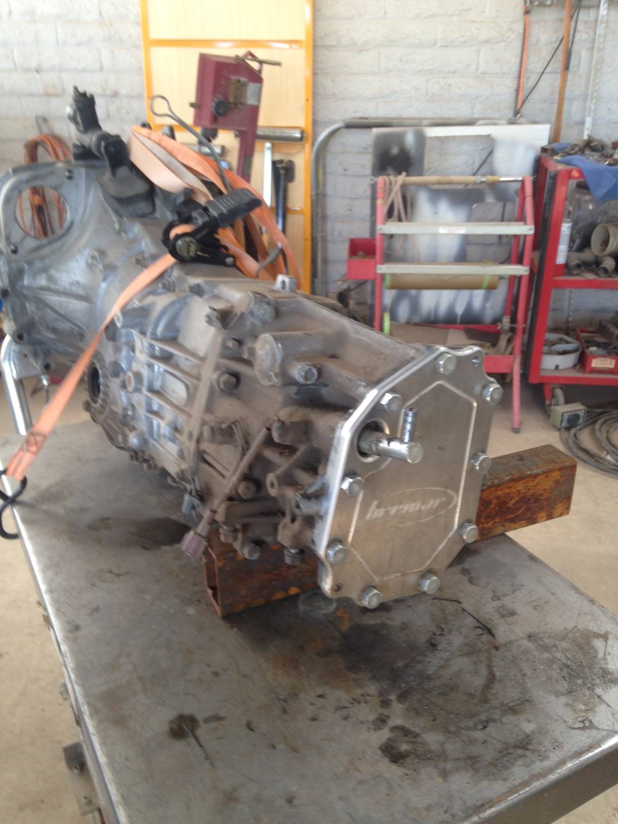

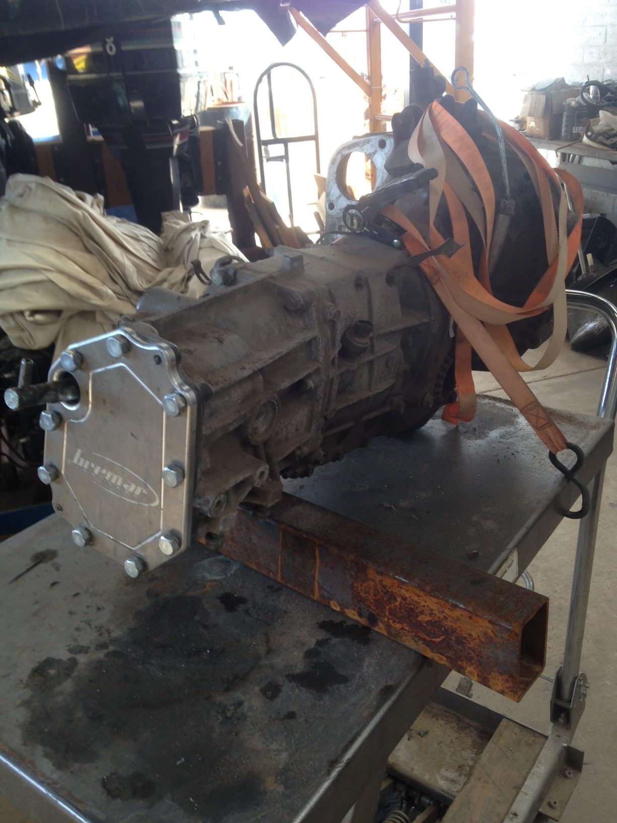

Back on a build. But having trouble with what way to go ? Build the want-to be 914 GT or restart the kit car what-to-be a 908-3 ?
Today I got the center diff out and the adapter on and end plate. This tran's could go on ether car.
But I also have a 914 trans with a adapter, starter,flywheel for a Subaru. I have a non-Sti ,turbo motor on it.
(IMG:http://www.914world.com/bbs2/uploads_offsite/i.imgur.com-8123-1541028422.1.jpg)
(IMG:http://www.914world.com/bbs2/uploads_offsite/i.imgur.com-8123-1541028423.2.jpg)
Maybe save the Subaru trans for the tube car ???
Anybody know the answer to the color question ?
