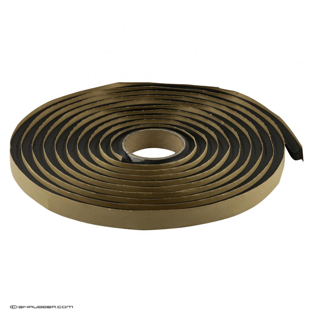

Hello Y'all,
Already purchased the Butyl tape, from 914 rubber.
Now I am reading in "Tech Tips 700" (tip 468) to use 1/4" (approx. 6mm) only.
Reason being is that a thicker kit will make the windshield sit too high and the chrome impossible to fit.
Does any one here have this experience with the 9.5mm butyl-cord sold by 914Rubber?
Would hate to go through all this hassle to find a problem like this.
In case it makes a difference, I have ordered the Sekurit branded Windshield from Prosource.
Thanks in advance (because I know one of you will advise).
Mikey914
post Nov 2 2018, 10:52 PM
The rubber man
Posts: 12,772
Joined: 27-December 04
From: Hillsboro, OR
Member No.: 3,348
You may want to use a thicker chord for smaller windshield, but we have the 8mm also -
https://www.shop.914rubber.com/Butyl-Cord-8...m?categoryId=-1
I used the 9.5 on mine.
