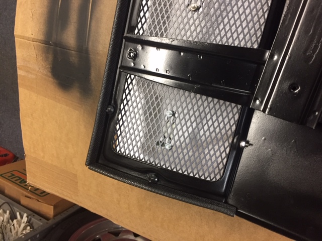

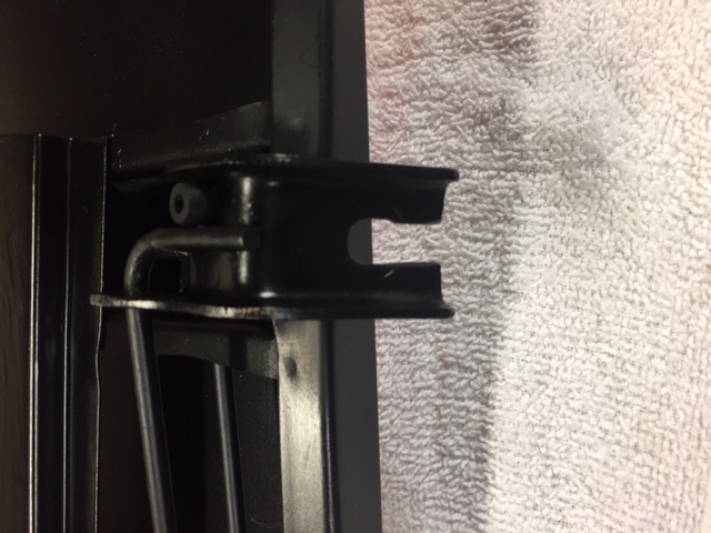

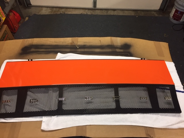

You'll be best served to remove the entire hood and work on it on a piece of carpet in your work area. 2 bolts and the entire hood comes off. It can be a one man job to remove it. 2 people is easier. I slotted the hood hing holes so I don't have to remove the bolts all the way to remove the hood. (IMG:style_emoticons/default/agree.gif) This is the Slot Spoke is referring to: To Marks Point, Once you remove the rain Tray, you should be able to access the letters on the grill ![]() I just finished working on my engine deck lid. ![]() |
