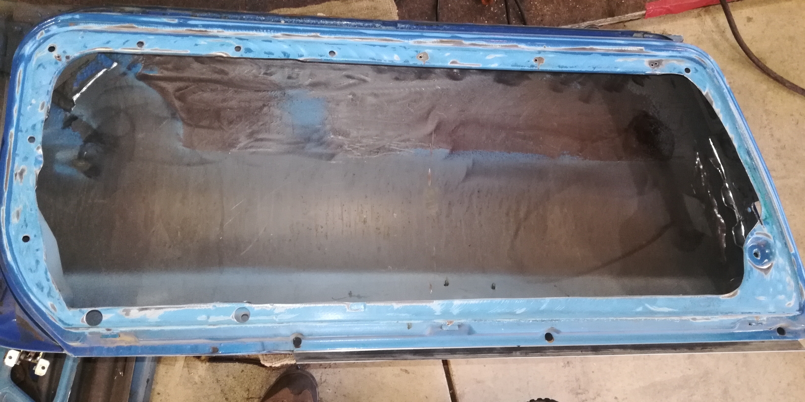

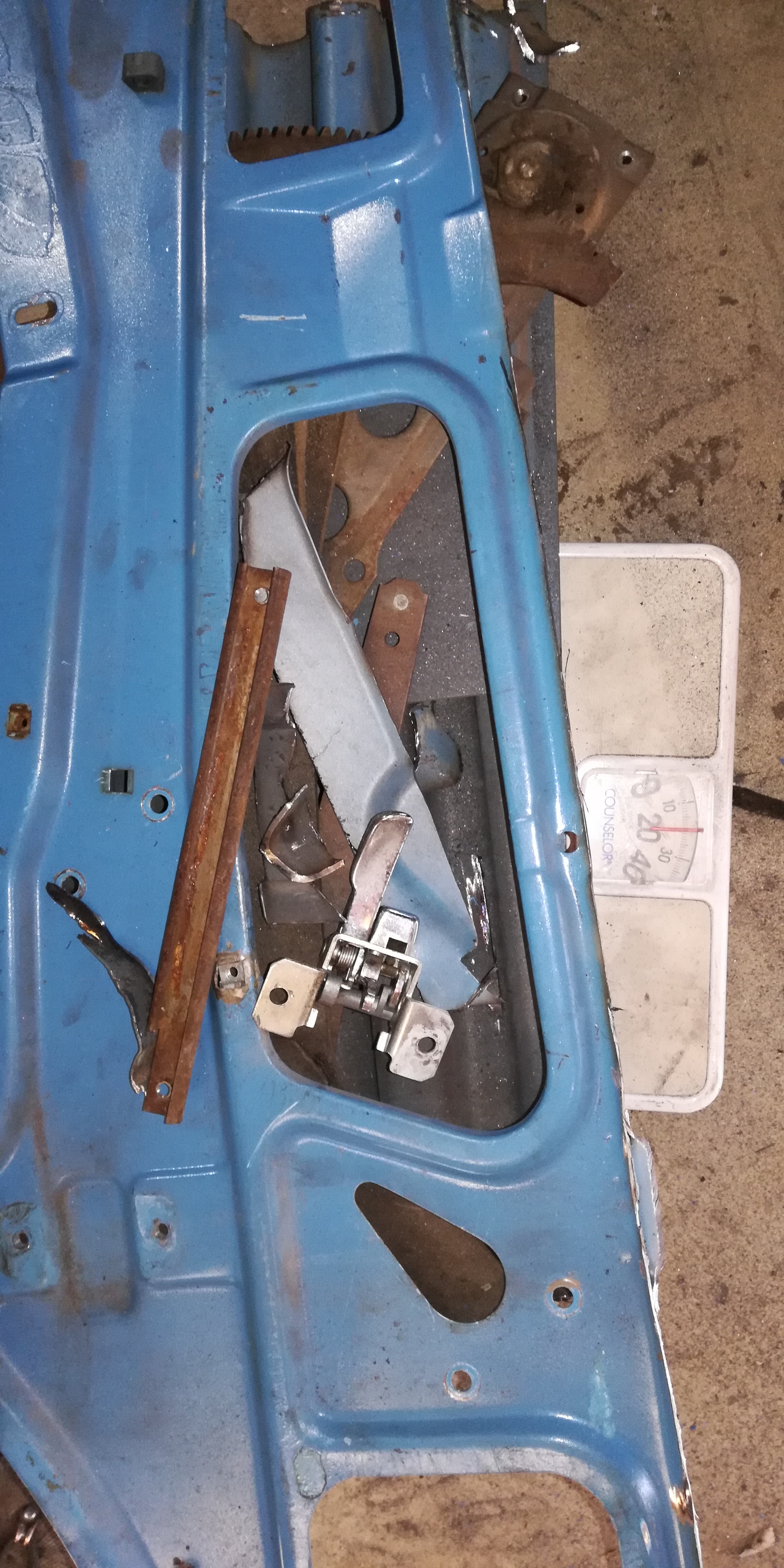

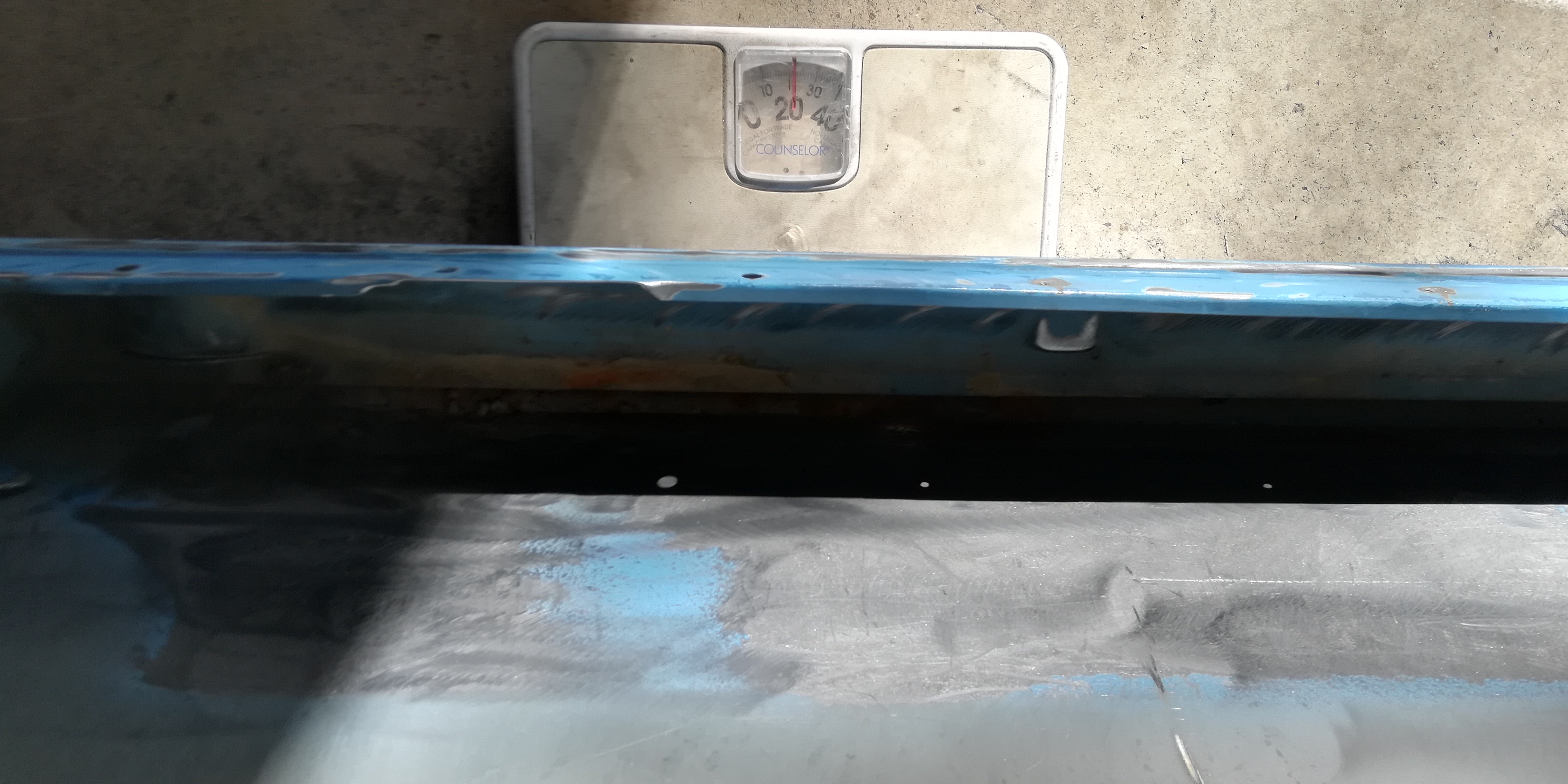

Here is the latest on the door lightening.
I did as suggested and just cut it as close to the edge as possible with a 3” cutter. I kept chipping away until I could get no more. My total door bar/beam weight removed was about 13-14#.
As is with a door latch, no windows 21#
Add-in the glass windows guides and door latch 35#
All items removed beams, window mechanism, sheet metal 20#
Seems consistent since I started with 55# for the full 1975 door.
