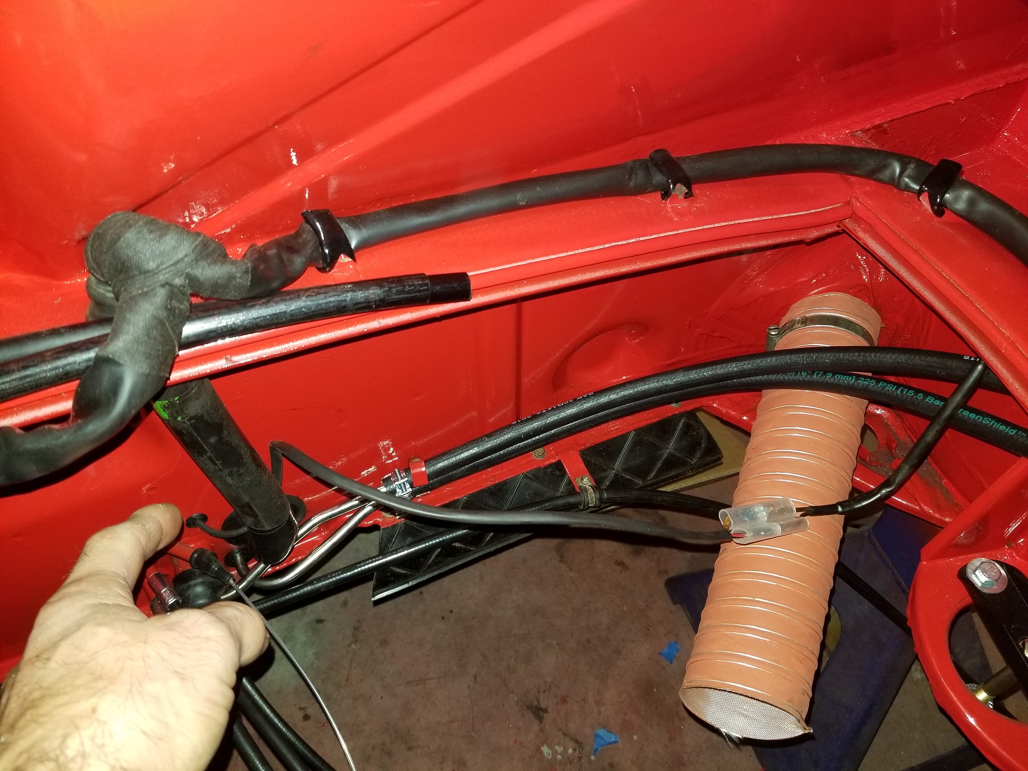

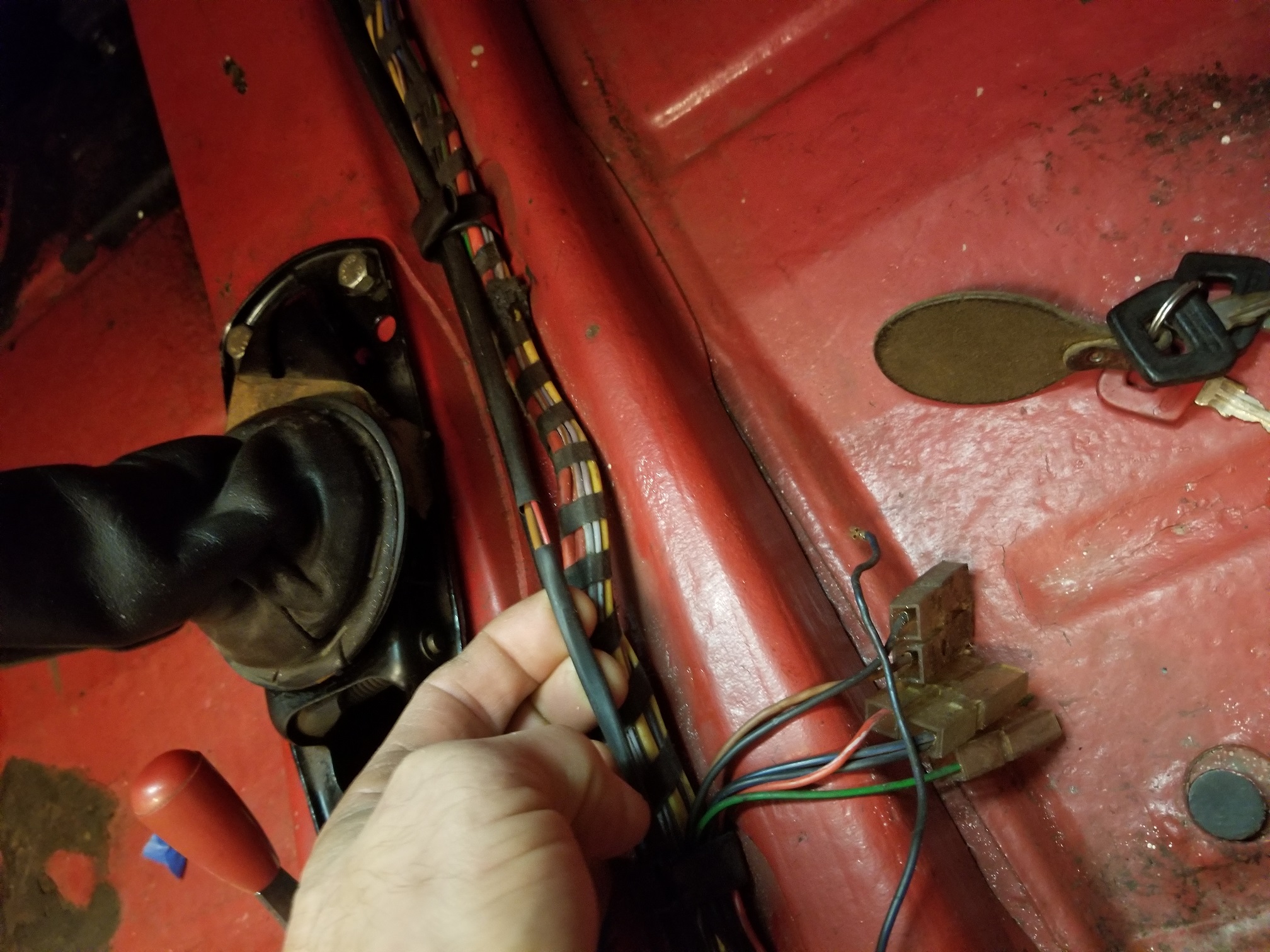

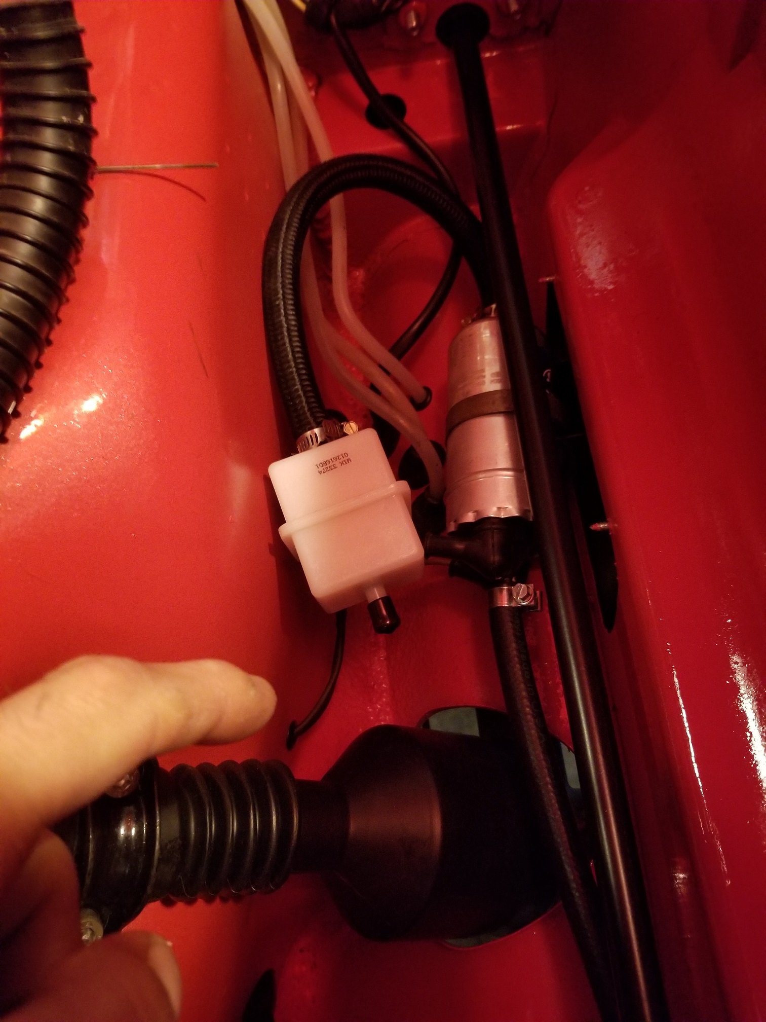

Believe it or not, I cant seem to find them in my harness. Not that they aren't there, I just don't know what they look like. So my understanding is that on a 73 the pump is located under the engine shelf, but all the wires go into the engine bay via the snorkel, so do the pump wires pass back down through the engine shelf?..

I just did mine on my 73 last week. Here is what i came up with. You can see the 2 spade connectors that i used to connect to the original harness and then extended with 14 gauge wire to the front trunk. Yes i will be securing the wires in the engine compartment.
Hope this gives you some ideas

yellowporky   I just did mine on my 73 last week. Here is what i...   Nov 23 2018, 08:48 PM
JeffBowlsby   The late cars required a 12ga wire and ground to t...   Nov 23 2018, 09:00 PM

trojanhorsepower   Looks good. Did you notch out the base of the sno...   Nov 23 2018, 09:07 PM
yellowporky   i guess i will re run 12 gauge wire now. No i did...   Nov 23 2018, 09:22 PM
trojanhorsepower   Ah, i see now, you ran it in through another hole ...   Nov 23 2018, 10:47 PM
