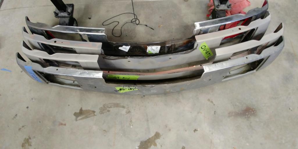

post Nov 26 2018, 03:03 PM
Posts: 7,829
Joined: 2-January 09
From: Burlington wi
Member No.: 9,892
I have 4 prepped for welding..
@ValcoOscar gets credit for precutting the one huge opening for a v8.. Attached Image

mb911   I have 4 prepped for welding.. @ValcoOscar get...   Nov 26 2018, 03:03 PM
wes   My excitement is building. Ah but just realized th...   Nov 26 2018, 06:36 PM
mb911   I have one more bumper coming in and then received...   Nov 27 2018, 10:11 AM
