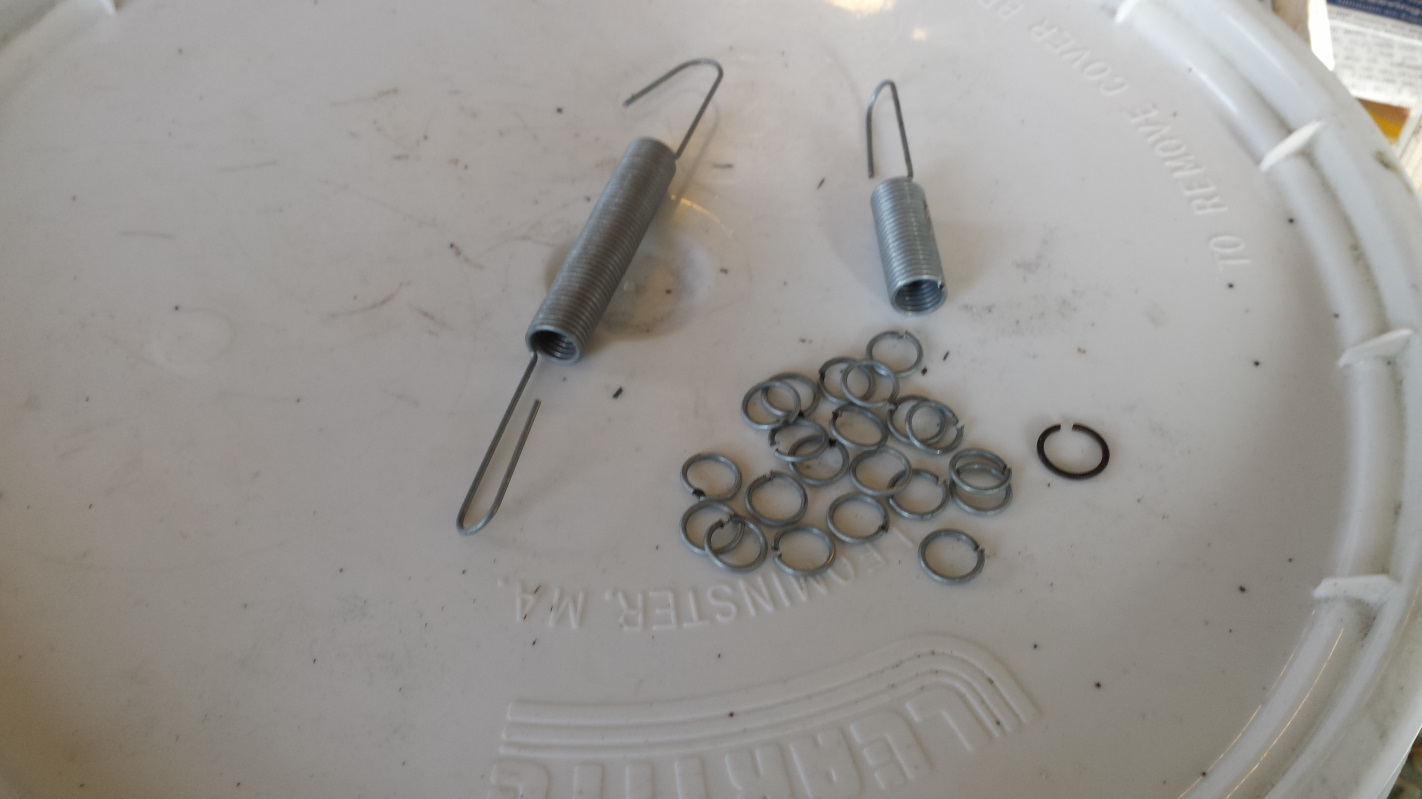

Hadn't given up on these clips. Easy to find in wholesale quantities but couldn't find anything within reason for small quantities. Then I had a flash of genius. Ever wonder what happens when you cut a coil spring lengthwise? I grabbed the closest match I could find in my parts bin and gave it a go. Wire diameter matches but spring diameter is a bit small (the rusty dark one is an original), but hell yeah it works! (IMG:style_emoticons/default/aktion035.gif) (IMG:style_emoticons/default/shades.gif)
Took about 30 seconds to make all these clips. Correct dimensions are 0.49" spring OD and 0.049" wire diameter. McMaster-Carr has a very close match that should work https://www.mcmaster.com/9654k398 Just need to source, cut, and send off for plating. (IMG:style_emoticons/default/piratenanner.gif)
