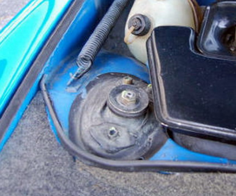

SirAndy   There are no cracks here, there was originally (fa...   Nov 29 2018, 12:02 PM

sixnotfour   Not cracks or welds ..the factory seal has been br...   Nov 29 2018, 12:19 PM
SirAndy   Not cracks or welds ..the factory seal has been b...   Nov 29 2018, 01:05 PM
sixnotfour   true view , It depends how much was piled on and m...   Nov 29 2018, 02:26 PM
