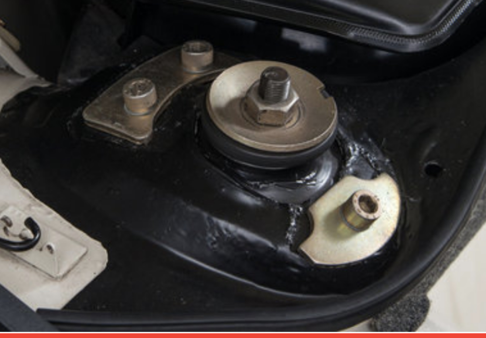

It is a nice looking vehicle up close. The lenses & ride height issues are somewhat easy to deal with - but agree that the expectation from these guys is nothing less than perfect. Thats what you are paying for...
BUT If I was signing the check, I'd like to know what the story is behind the fairly obvious repair on the front right strut mount area?
- Tony
QUOTE(Retroracer @ Nov 27 2018, 11:04 AM) *
Ugly welds too, looks like she had some work done in the past ...

Here?
Looks like the same stress cracking as on a blue car I looked at in SoCal.
I'm going to start a new thread on this to talk about / learn how to repair that correctly,

There are no cracks here, there was originally (factory 914/6s) tar around the top mounting area of the strut. This restoration started with a very clean chassis although I would agree that the black underside was a mistake.
Yep that's exactly my thinking as I mentioned in the other thread.
Except, the tar was all scraped off and the area was simply painted black.
So, no tar, just black paint, then what the heck is that if no a ugly weld bead?
sixnotfour
Not cracks or welds ..the factory seal has been broken, and hardware replated ,,and new alignment,,leaving the old imprint of the factory alignment.....SIX
edit and some blk touch up....he should have put a pile of black goo on it like the factory did,,,
QUOTE(sixnotfour @ Nov 29 2018, 10:19 AM) *
Except, the shape of the "whatever" does not match the mounting hardware.
If it was leftover goop from the factory, you'd think it would show the shape and outline of the mounting hardware.
sixnotfour
true view , It depends how much was piled on and may affect the pop off shape....some had a ton , some a little bit..
