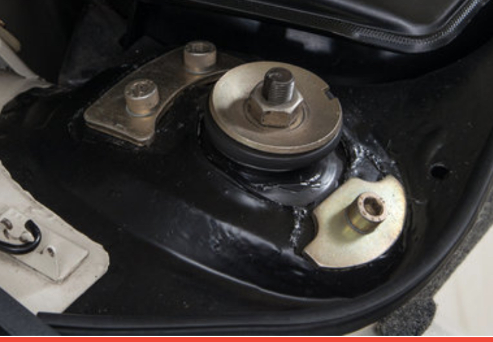

It is a nice looking vehicle up close. The lenses & ride height issues are somewhat easy to deal with - but agree that the expectation from these guys is nothing less than perfect. Thats what you are paying for...
BUT If I was signing the check, I'd like to know what the story is behind the fairly obvious repair on the front right strut mount area?

QUOTE(Retroracer @ Nov 27 2018, 11:04 AM) *
Ugly welds too, looks like she had some work done in the past ...

QUOTE(SirAndy @ Nov 27 2018, 05:32 PM) *
(IMG:style_emoticons/default/smash.gif)
Here?
Looks like the same stress cracking as on a blue car I looked at in SoCal.
I'm going to start a new thread on this to talk about / learn how to repair that correctly,

QUOTE(Tdskip @ Nov 29 2018, 07:41 AM) *
Here?
There are no cracks here, there was originally (factory 914/6s) tar around the top mounting area of the strut. This restoration started with a very clean chassis although I would agree that the black underside was a mistake.

QUOTE(gms @ Nov 29 2018, 03:01 PM) *
Here?
Yep that's exactly my thinking as I mentioned in the other thread.
