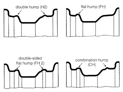

Someone posted this 1971 spec page.
I noticed the four had tubeless tires but the six had tubed tires.
Can someone please share why they were different..
johnhora
post Nov 30 2018, 08:31 AM
Posts: 888
Joined: 7-January 03
From: Derby City KY
Member No.: 107
Early 911 wheels like the deep 6" Fuchs didn't have the tubeless "hump" formed on the inside of the rim. Supposedly this keeps the tire bead from slipping to the inside of the rim and sudden loss of pressure. This could happen with low pressures and severe cornering. So they used tubes like most early cars.
go hear for all you want on the patent
https://patents.google.com/patent/US4606390A/en
