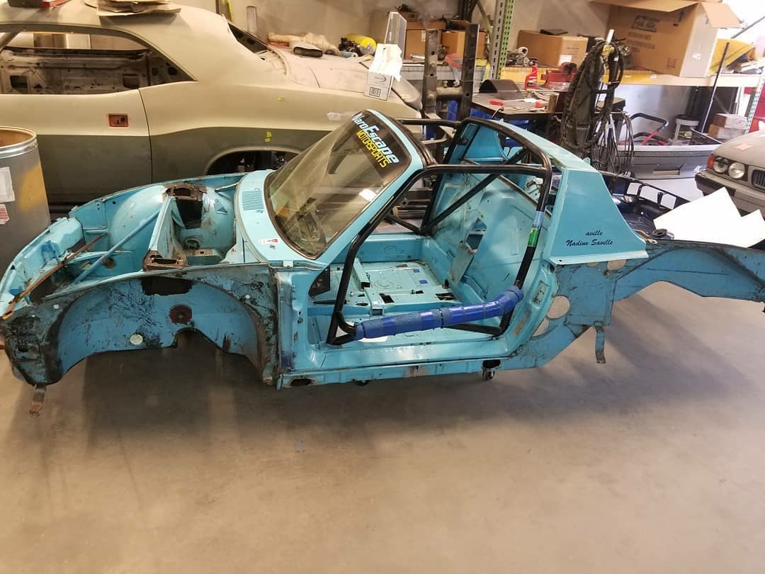

with all the work we're doing on Papa Smurf, one of big pieces of the development is tying the roll cage to the rear and front suspension points, plus doing tubing to strengthen other points around the car.
Would like to see how people run the tubes from the roll cage, through the fire wall or window, through the engine compartment area, into the rear trunk to the shock towers. We have things in the way there, but will move around if needed....

That’s what my cage crossbar is like and it’s legal

QUOTE(naro914 @ Dec 5 2018, 08:31 AM) *
The diagonal is fine, but without a horizontal crossbar it is not approved for wheel to wheel racing.

This is how the cage has always been in our car
I’ve run multiple SCCA club races like this.

ChrisFoley   Without a full width main hoop crossbar that cage ...   Dec 5 2018, 06:12 AM

Chi-town   Then the Tech inspector wasn't doing his job. ...   Dec 5 2018, 09:53 AM
