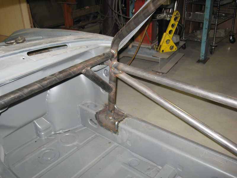

with all the work we're doing on Papa Smurf, one of big pieces of the development is tying the roll cage to the rear and front suspension points, plus doing tubing to strengthen other points around the car.
Would like to see how people run the tubes from the roll cage, through the fire wall or window, through the engine compartment area, into the rear trunk to the shock towers. We have things in the way there, but will move around if needed....

Forward hoops which penetrate the stock dash are generally necessary to get the "knee bar" in a safe location.
A bar which is bent at both ends to make it closer to the front bulkhead is perfectly legal and makes the cage much sturdier than one with no dash bar.
This dash bar will not be anywhere near the drivers knees. However it may interfere with some gauge packages.

ChrisFoley   Without a full width main hoop crossbar that cage ...   Dec 5 2018, 06:12 AM
naro914   That’s what my cage crossbar is like and it’s ...   Dec 5 2018, 07:31 AM
ChrisFoley   That’s what my cage crossbar is like and it’s...   Dec 5 2018, 07:35 AM

brant   agreed with Chris knee bars go inside the dash an...   Dec 6 2018, 11:03 AM
Brett W   Yup, you need a better fabricator. Proper dash ba...   Dec 9 2018, 11:14 AM

GregAmy   Good morning! Just catching this thread, wante...   Dec 11 2018, 08:56 AM

ThePaintedMan   :agree: Greg nailed it. Which also makes me re-thi...   Dec 11 2018, 10:53 AM

GregAmy   There are a lot of different designs that people u...   Dec 13 2018, 10:24 AM
