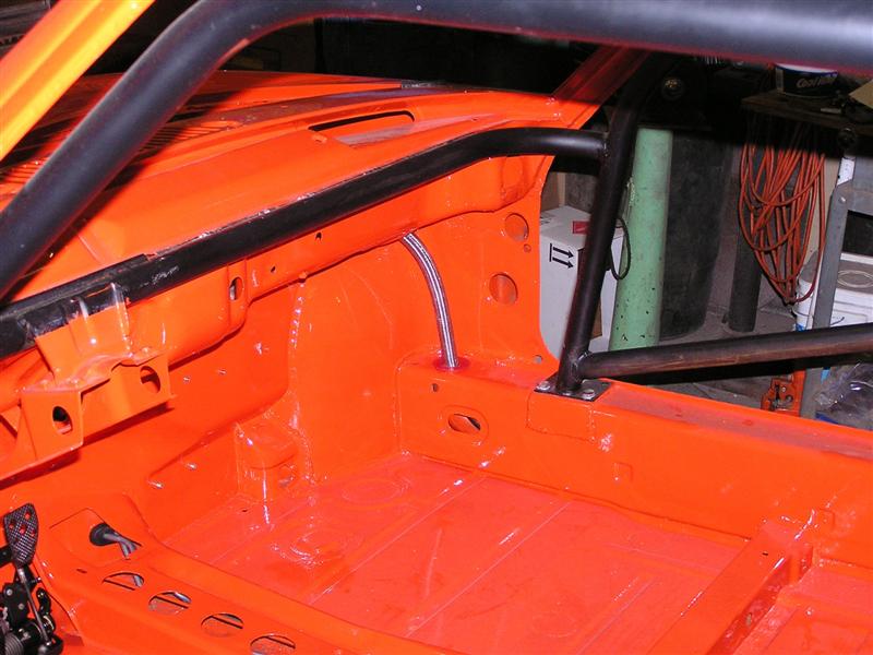

Ours:

brant   Ours:   Dec 10 2018, 09:59 AM
