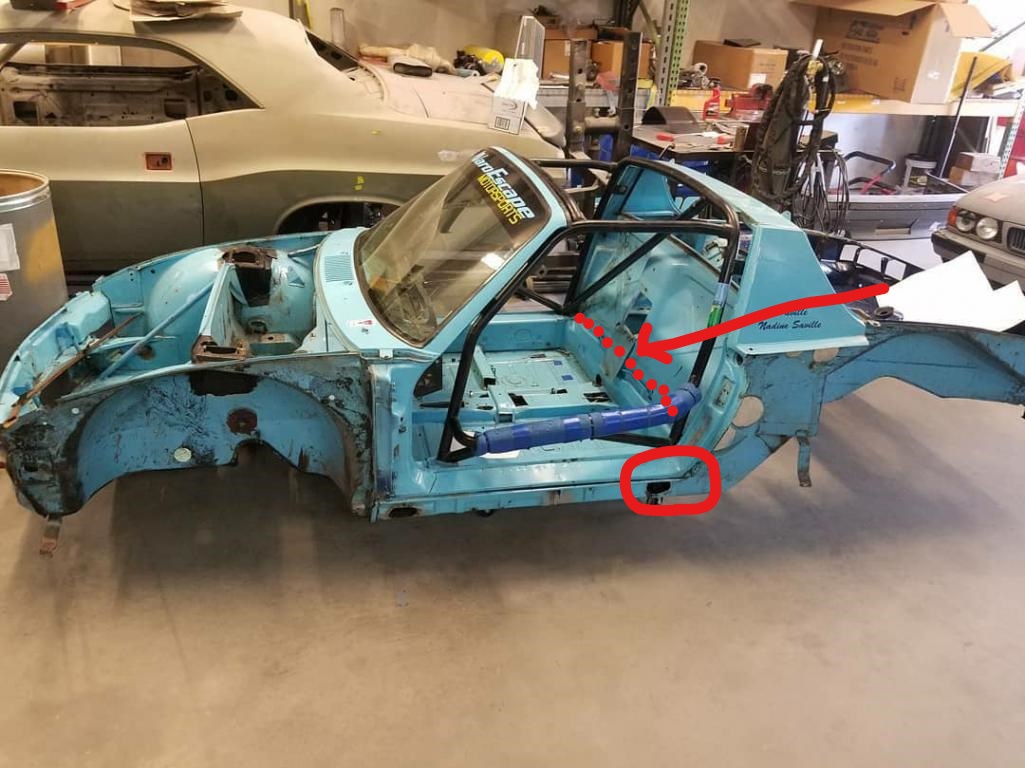

with all the work we're doing on Papa Smurf, one of big pieces of the development is tying the roll cage to the rear and front suspension points, plus doing tubing to strengthen other points around the car.
Would like to see how people run the tubes from the roll cage, through the fire wall or window, through the engine compartment area, into the rear trunk to the shock towers. We have things in the way there, but will move around if needed....

Yup, you need a better fabricator. Proper dash bar goes no where near sensitive body parts.
Since you have GT type car, I might even be tempted to "remove" the targa bar, put the main hoop back in the middle of the targa bar and then reinstall the skin of the targa bar around the cage. Pretty time consuming, but it would be really slick moving the main hoop back another 3-4in to help re-position the driver.

Definitely want a dash bar and a horizontal bar across middle or bottom of the roll hoop too. Otherwise you risk having the cage fold in on you in the event of a hard side hit.

QUOTE(stownsen914 @ Dec 9 2018, 10:00 PM) *
Definitely want a horizontal bar across middle or bottom of the roll hoop too. Otherwise you risk having the cage fold in on you in the event of a hard side hit.
if you modify the cage I would agree with this as another very important addition
If the car is hit (Tboned) at the factory jack point
the long will crush and move inward
As the car is crushed inward, the seat belts will tighten and crush the occupant
914's are notoriously weak in this side impact... and I have seen longitudinals move 12 inches inward... pushing the floor pan 12 inches... pushing the seat mounted to the floor pan 12 inches... and causing any seat belts to squeeze the occupant about 12 inches tighter than they were adjusted to
also with the factory brace bar cut out of the floor pan
(forward seat adjusting mount from the factory)
The vehicle and floorboard are even more susceptible in a side impact
you may want to add that factory cross brace back in. its a safety item
