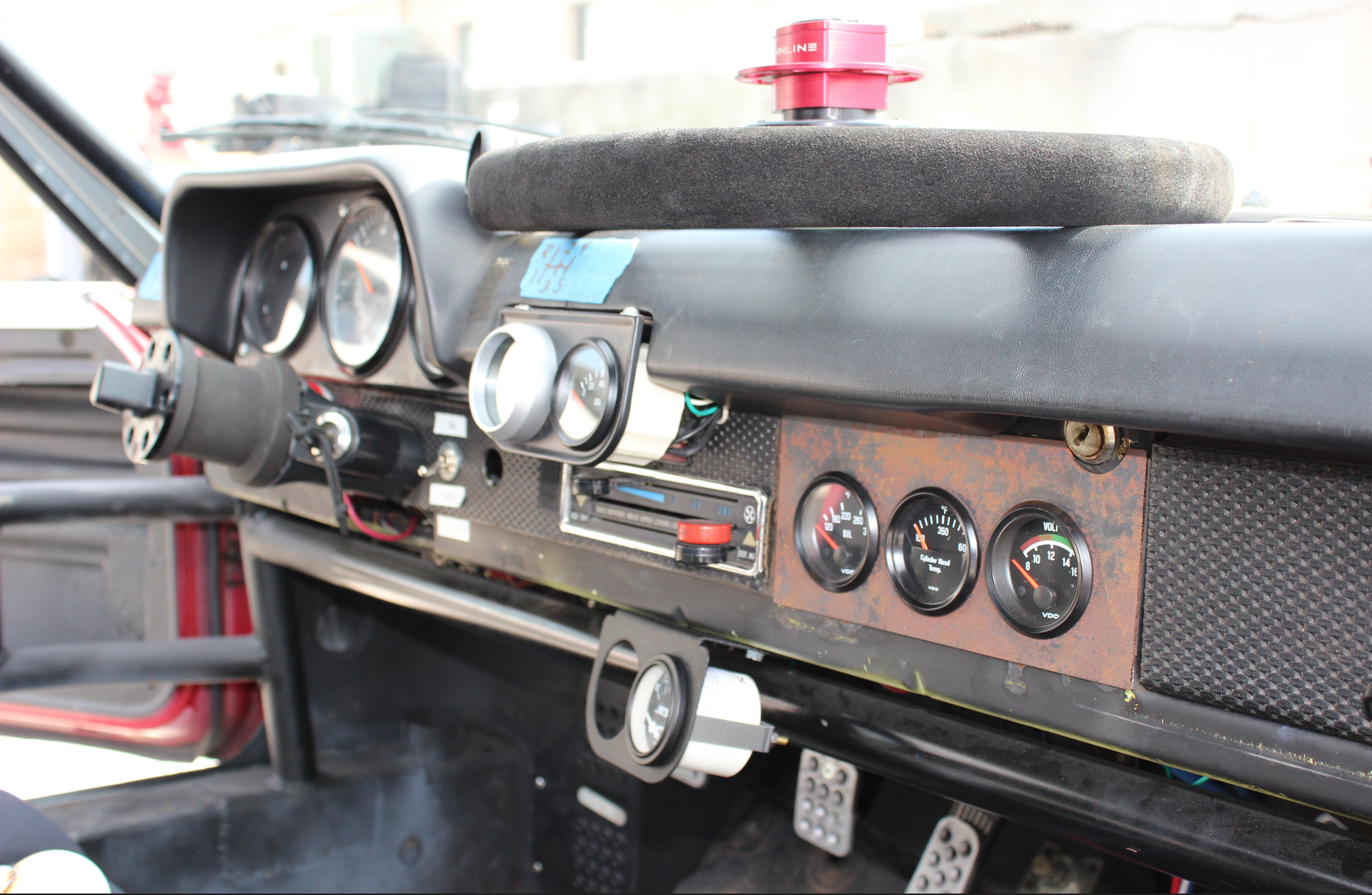

My knee bar, from Tangerine.

naro914   OK then, can someone show pictures of their knee b...   Dec 10 2018, 07:15 AM
Jetsetsurfshop   My knee bar is almost touching the lower part of t...   Dec 10 2018, 08:36 AM
ChrisFoley   Forward hoops which penetrate the stock dash are g...   Dec 10 2018, 09:22 AM
brant   Ours:   Dec 10 2018, 09:59 AM
Brett W   Sounds like your seat is pushed too far forward or...   Dec 10 2018, 11:31 AM
naro914   Nadine sits with the seat as far forward as she ca...   Dec 10 2018, 11:43 AM
Jetsetsurfshop   My knee bar, from Tangerine.   Dec 10 2018, 01:33 PM
Brett W   Too low, Nadine is now an amputee. That design wo...   Dec 10 2018, 09:15 PM
