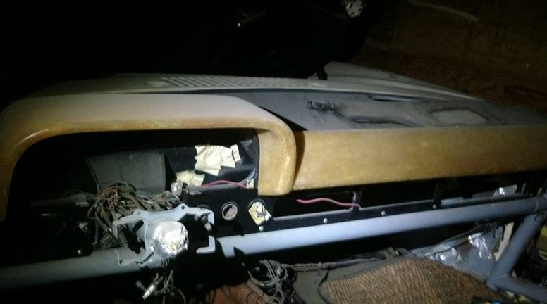

sixnotfour
post Dec 11 2018, 12:16 PM
Posts: 11,184
Joined: 12-September 04
Member No.: 2,744
I cut the dash so the knee bar would be higher...hopefully not being a knee bar.....with a pad its the same height as the factory dash knee pad
