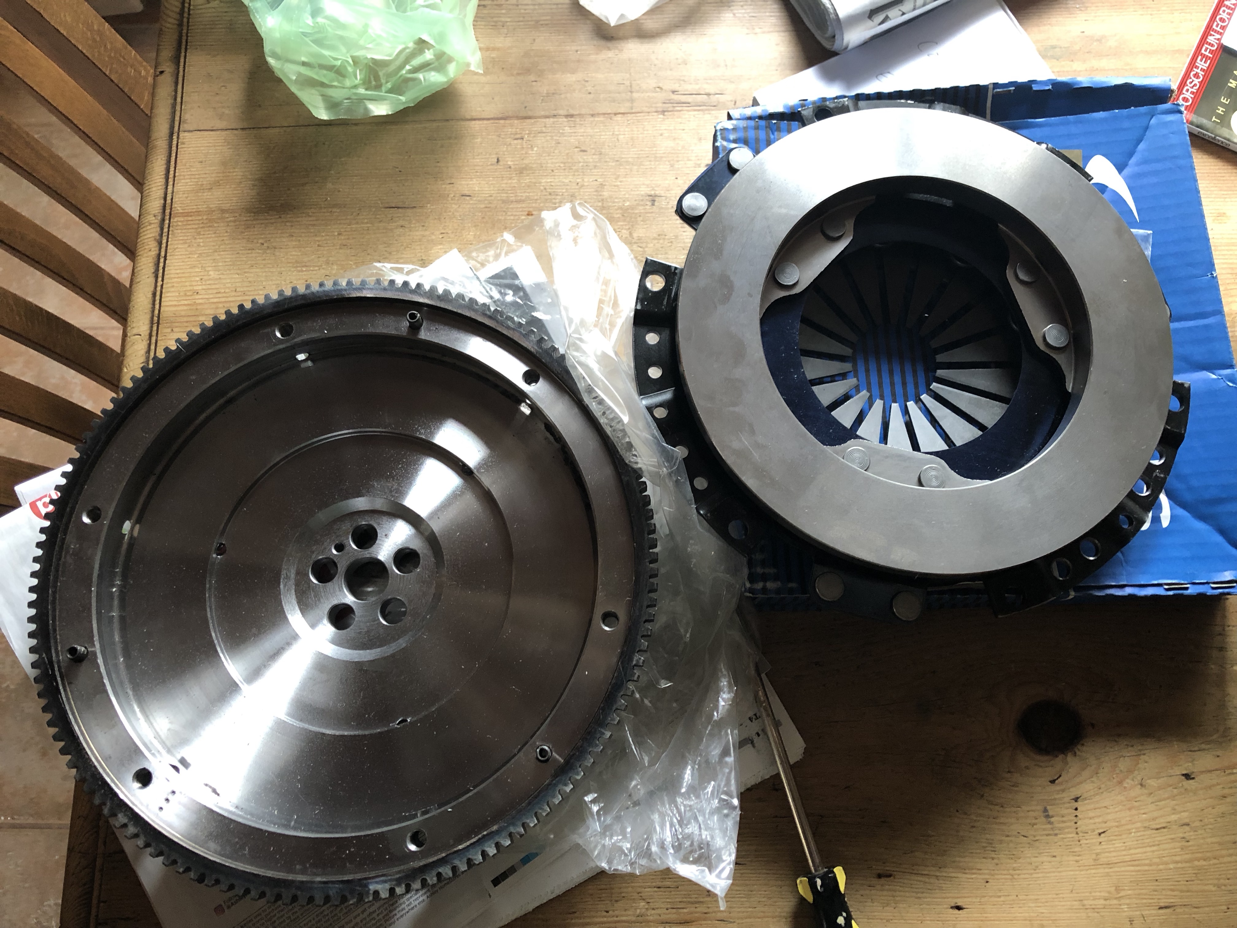

I've never had a Stage 1 clutch in a Type 4. The KEP Stage 1 (modified Sachs) feels really heavy on the pedal. I'm OK with it as long as nothing is wrong. Anybody had the same?
I imagine if this is "normal", I should switch to a Delrin pulley... Attached thumbnail(s) |
