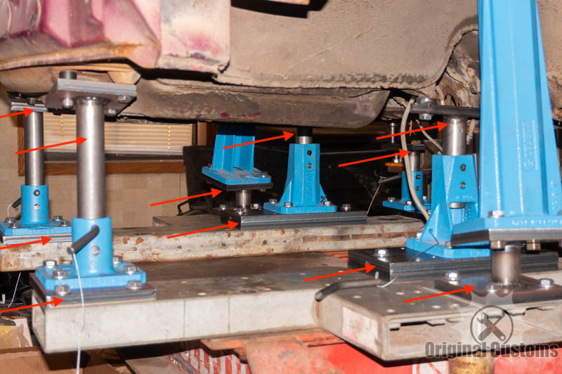

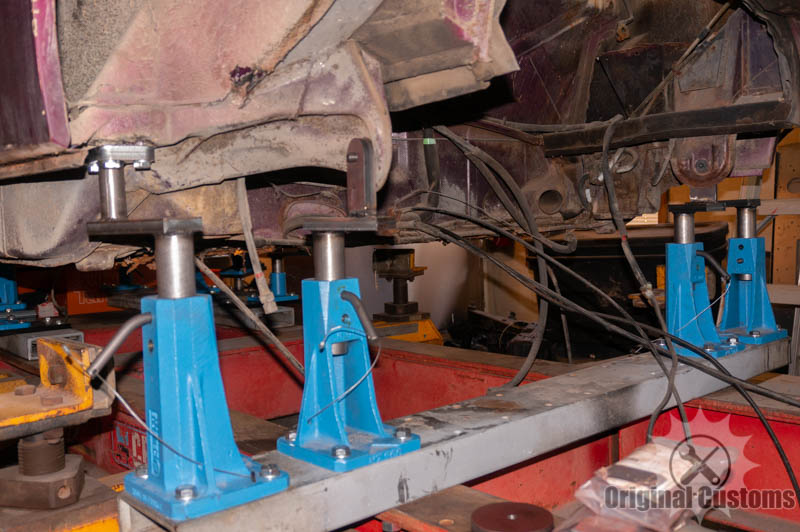

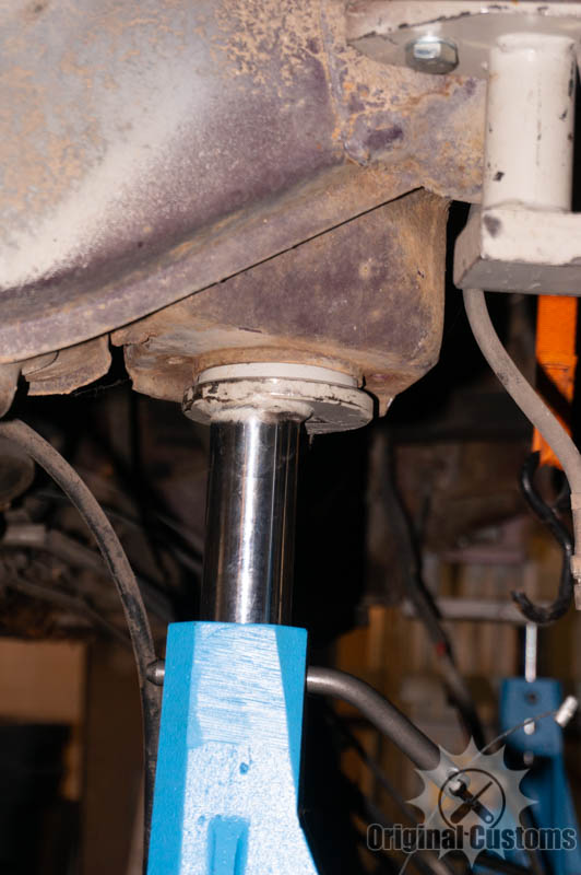

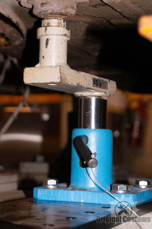

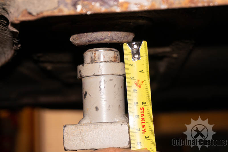

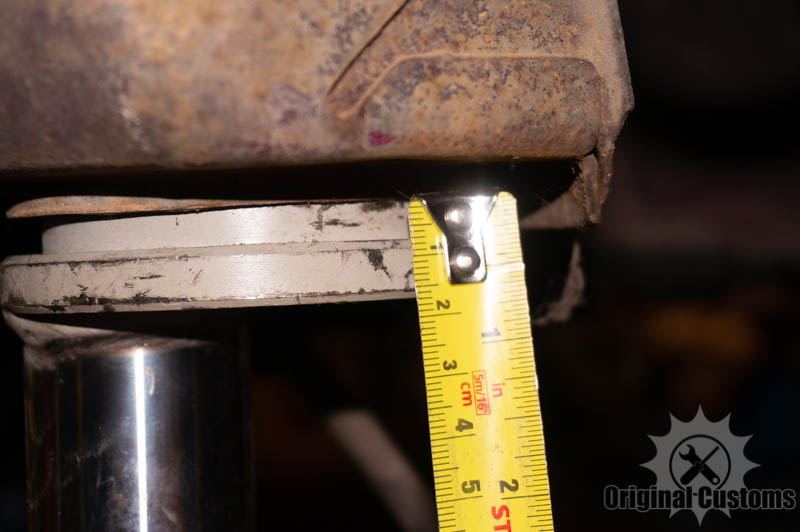

Here's a few shots of the inaccurate fixtures. Remember that this car shows no evidence of crash damage and these pictures were taken with the car mounted to the official Celette Fixtures. The front A-Arm mounts (front and rear) and the rear trailing arm mounts (inner and outer), as well as the transmission mounts, were all in place and lined up perfectly 'out of the box'. So there's just no logical way that these gaps should exist.
