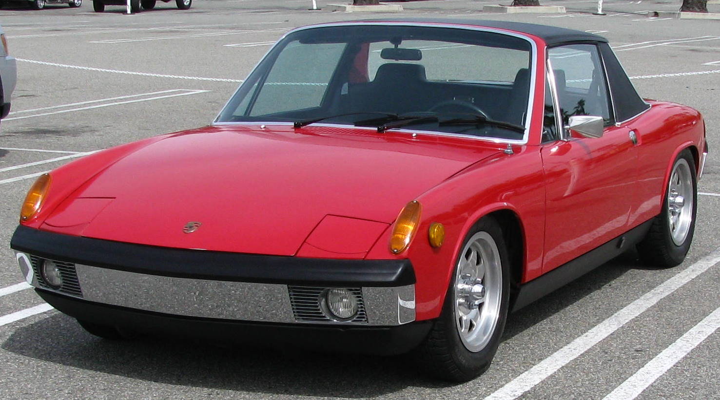

My buddy Jerry has a reason to keep his OO `71 /4 with +/-61k miles as stock as possible (& it has some dealer installed "options" from new already) - but not everybody is in his boat to maximize value of a collector car that he's babied for 47+ years. Heck - he rolls it in & out of his garage to hand wash it! (IMG:style_emoticons/default/blink.gif)
.... & that is the original Bahia Red Paint! (IMG:style_emoticons/default/drooley.gif) (IMG:style_emoticons/default/wub.gif)
