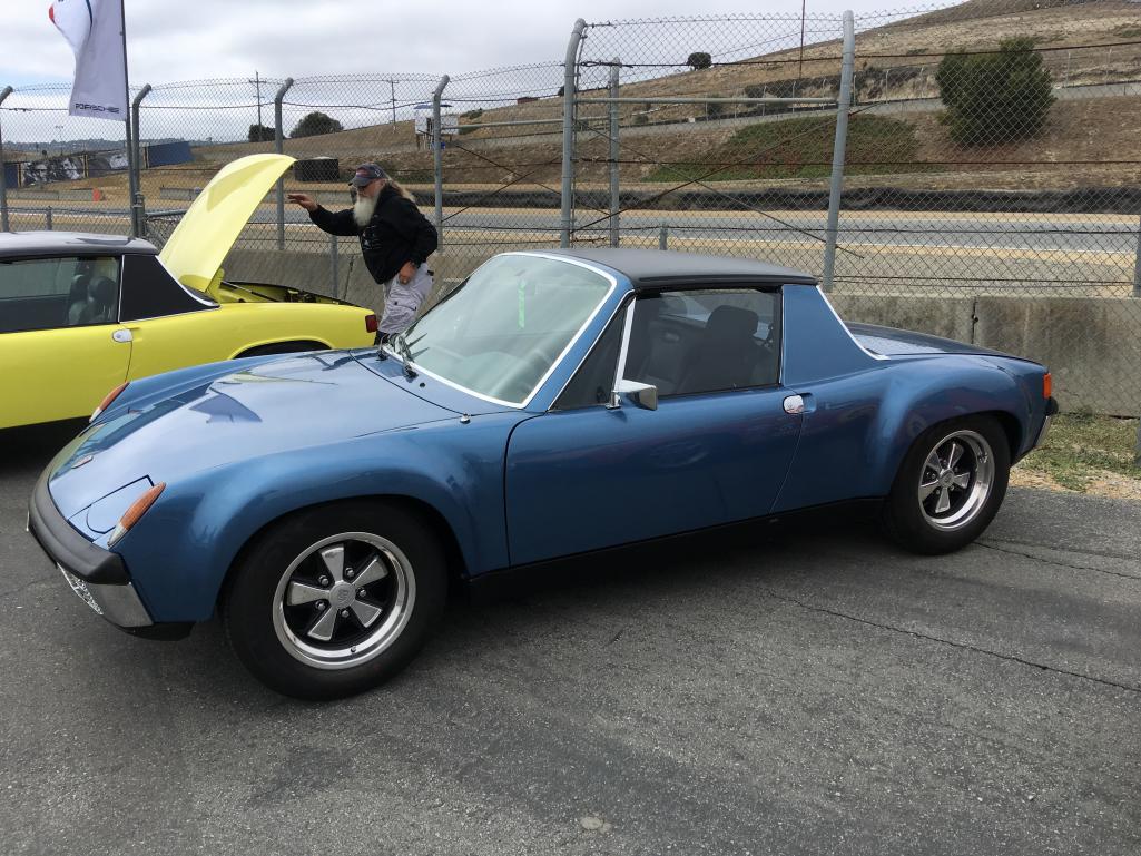

Here she is at Rennsport Reunion VI.
Turned out the distributor was off a couple teeth and a bunch of other stuff. The car is fully sorted for safety but needs some rework on the carb side to get it dialed in. New tires eventually, a proper front valence, and a parasitic battery drain. Short list.
Actually considering selling in 2019. I want to build another car.... stupid hobby.
