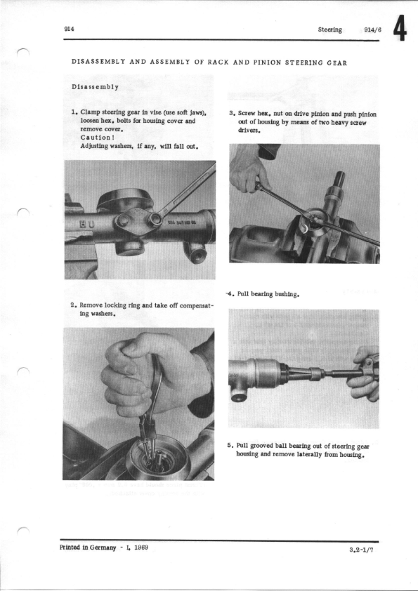

I just did this last weekend. That bushing is the oil seal and will need to be replaced regardless of how badly you tear it up. Post #18 in this thread has the size for at least one of the three versions of rack that were used. Mine was a PITA to install because the original seal had an exposed metal outer race that was seized. I used plenty of penetrating oil and some heat before it came loose. Below is the page from the factory manual with the removal procedure. In theory following that procedure should lift the pinyon along with the upper bearing and seal/bushing out of the bore. It didn't go smoothly for me but it at least popped the seal loose enough that I was able to push the pinyon back down (with some difficulty) and finally pry the seal out.
