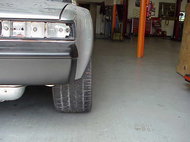

dgw   This is on my car, work for me. I had to shave the...   May 19 2003, 10:26 PM
boxstr   255x50x16s are on the back of this steel flared 91...   May 19 2003, 10:36 PM
Qarl   Who's car? Any more pics?   May 19 2003, 10:40 PM
SirAndy     May 19 2003, 10:48 PM
