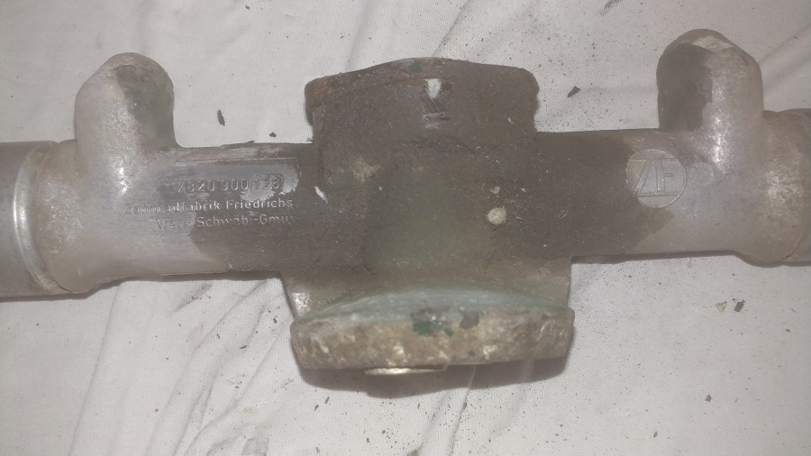

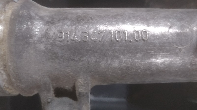

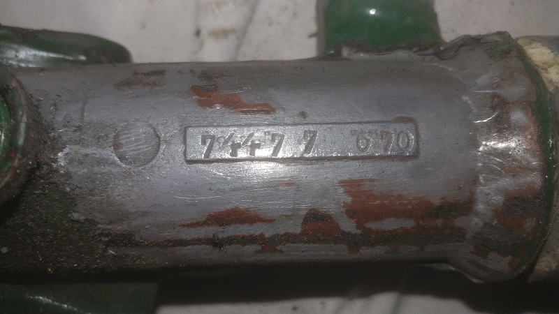

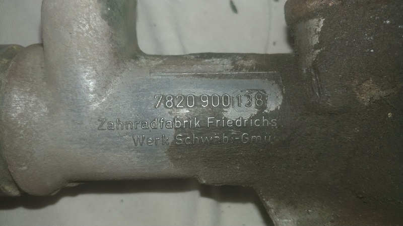

Hi Mark,
I have two steering racks which would need a refresh. One came out of a 71 914-4 (914.347.101.00) and the other out of my factory 6 (7820 900 138). I would need the 6 rack rebuilt for sure. When I removed the rubber boots I could see that grease was getting past the seals at both ends.
Do you sell a rebuild kit for the 6 (ZF) rack ? I checked your site but wasn't able to locate a kit.
Here's a few pics.
