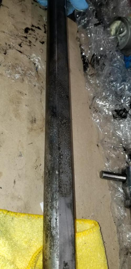

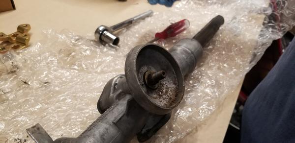

We do not sell the "kit" as we have found there are many variations. Bearing sizes, drag tension pucks and even the end bushings have 4 different variations after doing about 35 we still get surprised by variations. Just the other day a did a 912 one and found that even though they looked identical to others that we have done it utilized a bearing that we could not source as it was an oddball size. (fractional mm .5). No crossover to inches. Wound up manufacturing a part to utilize a bearing we could get. That and we have found all kind of DAPO "rebuilds" My favorite was the drag puck that was put back together without the sacrificial tension cover. Metal on metal. Tor the crap out of the shaft, but you couldn't tell until you took it apart. It just turned really hard. Opened it up to find lots of metal in the grease.
For something that seems pretty simple it can be more complicated.
Here's one the customer had written off as it was unable to turn and had rust inside.
