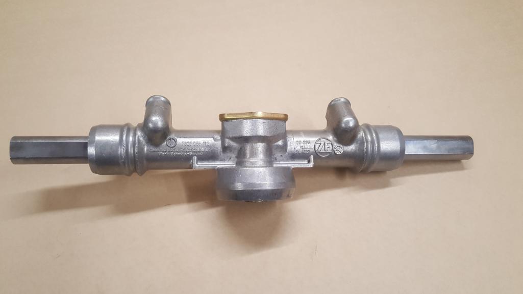

Thought I would install my Turbo tie rod ends and found that one of the rack end bushings had stuck to the rack and pushed it out. ( probably during storage )
I found a rack rebuild thread by Wes V
http://www.914world.com/bbs2/index.php?showtopic=95747
But it seems his rack is different than mine. his is a 75 mine is a 73 . I didn't know they changed them.
So it looks like I will have to disassemble my rack and clean up / polish the rack rod.
problem is I can't seem to find a number for the seal. Part #10 in diagram
Also the 911 rack ( and later 914 rack ? ) has a needle bearing at the top whereas, it looks like the 73 rack has caged ball bearings top and bottom.
My rack part number is 914.347.014.00
I haven't disassembled mine yet.
Does anyone have part numbers for the bearings and the seal? are the caged rollers the same number as in the 911 rack? # 6202. and if I can't find the seal could I just go with a sealed 6202 bearing (if available) on the top and skip the #10 seal?
I put PB blaster on the stuck end bushing last night and will work on it later today.

Mikey914   Here's what we did   Jan 1 2019, 08:29 PM
Mikey914   another While not perfect still a great part   Jan 1 2019, 08:31 PM
Mikey914   another   Jan 1 2019, 08:31 PM
Mikey914   more   Jan 1 2019, 08:32 PM
Mikey914   We were dong another baked finish, but I like the ...   Jan 1 2019, 08:34 PM
