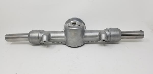

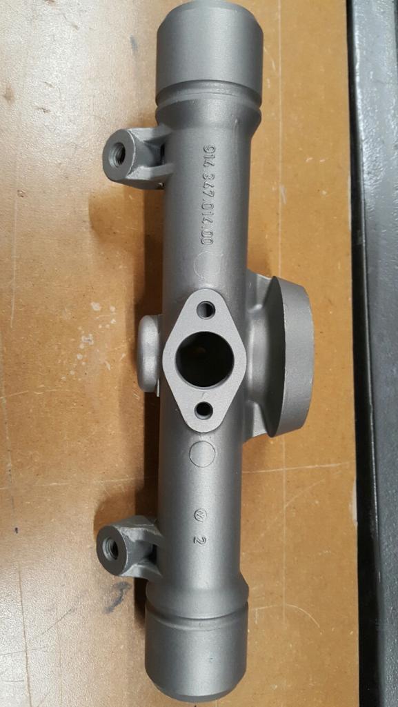

Mikey914   Here's what we did   Jan 1 2019, 08:29 PM
Mikey914   another While not perfect still a great part   Jan 1 2019, 08:31 PM
Mikey914   another   Jan 1 2019, 08:31 PM
Mikey914   more   Jan 1 2019, 08:32 PM
Mikey914   We were dong another baked finish, but I like the ...   Jan 1 2019, 08:34 PM
