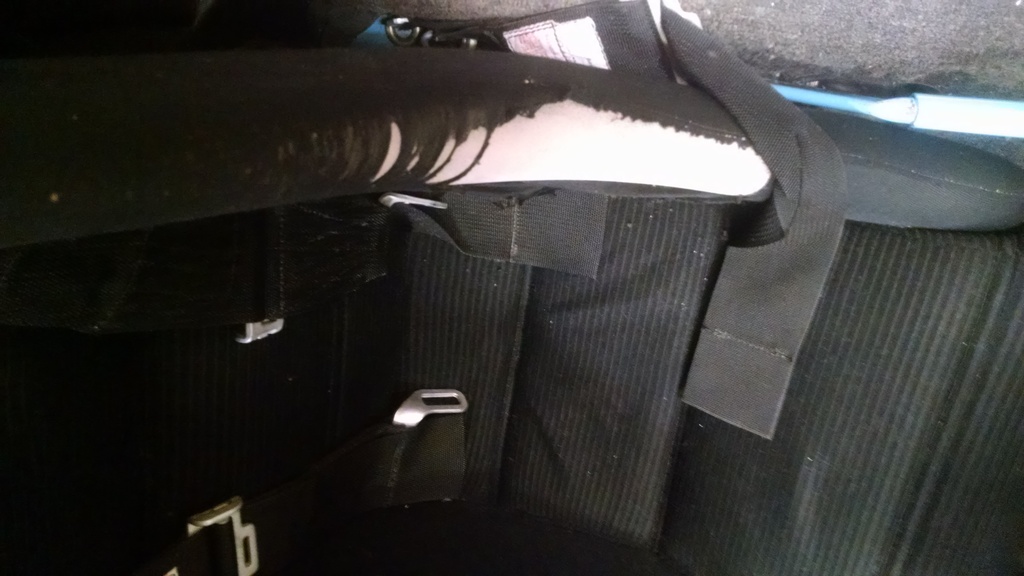

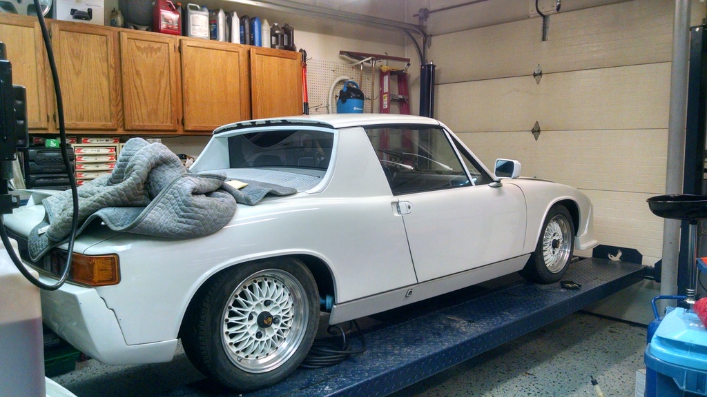

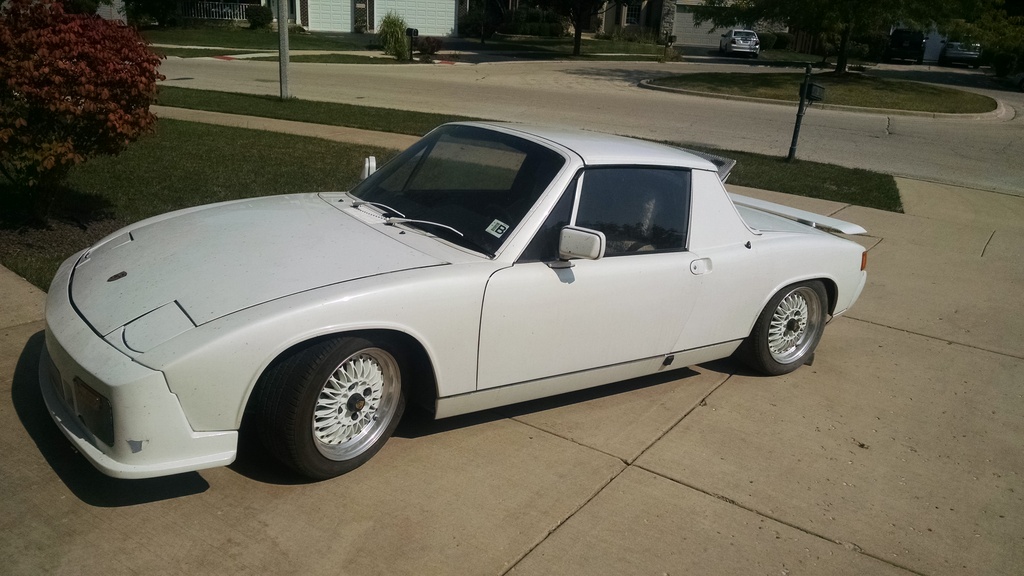

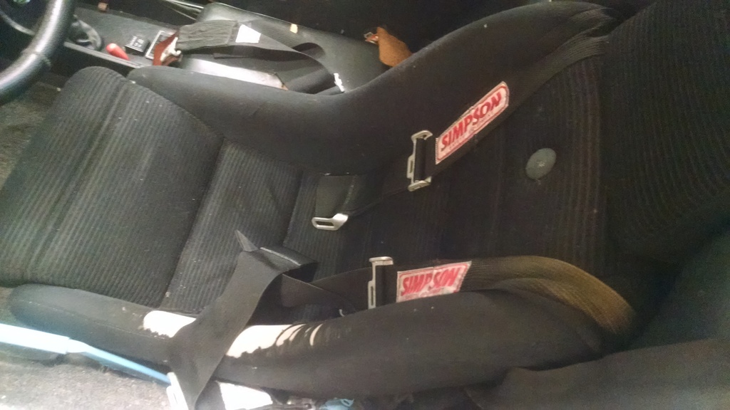

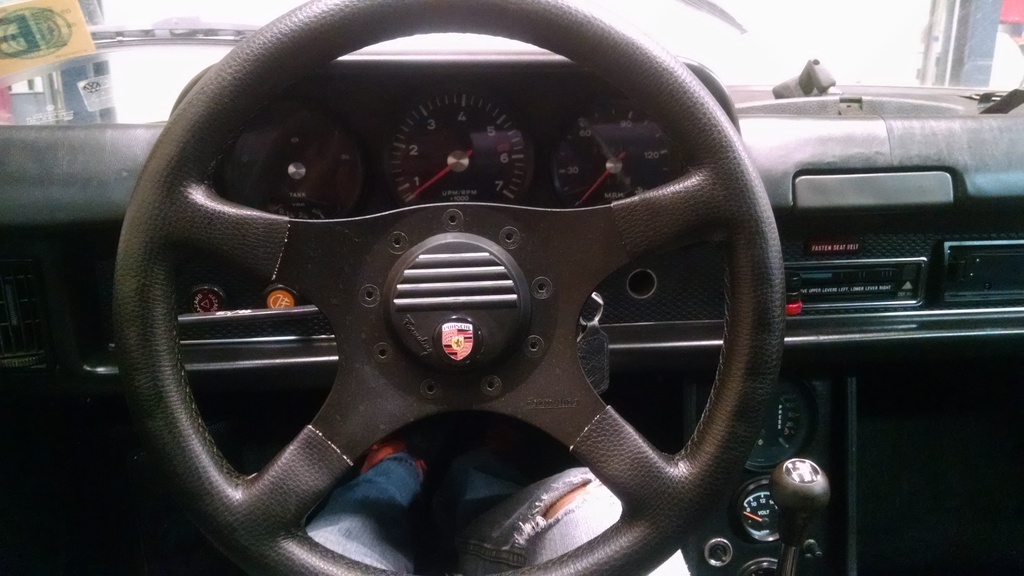

Finally got the car back to IL and started to clean it up. Overall he car is in really good shape. There is virtually no rust on it. Just a very little bit starting to form on the front fender by the hood. The paint is in really good condition but will probably need a new paint job as there are some chips in that that won't be able to touch up since it is 30+ years old. Will need the Recaro seats to be redone and will need a new arm rest. Drained the old gas out of it and then drained the oil which was mostly sludge. Bought sludge remover and put that in the case to help break it up. The mice ate the plug wires and the battery is totally shot. What spark plugs and wires do you guys recommend?
Here are a few picture.
